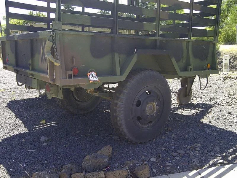

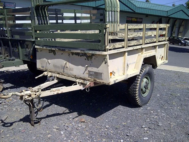

these are at a military surplus place at, Supply Depot, 310 Southeast Railroad st, Bend, Or.
I know these seem to be popular, I don't know how flexible the price is, but they look to be in good shape.

Excellent. The one trailer looks to be a 1 ton but the 3/4 is about right. Any idea what the price is being asked?
I will check into this, I do appreciate your help.
Thanks much
:cheers:
The trailer on top, the green one, is a M105. Made for the 2 1/2 ton trucks. If you want to shop around some, go to Steel Soldiers. They have a classifieds, there are plenty of 101's out there.
both trailers were $750

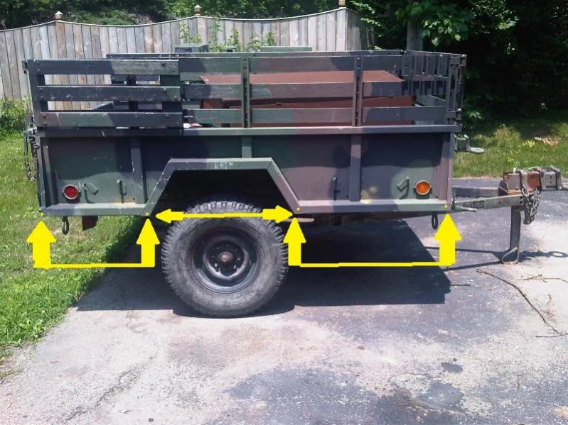

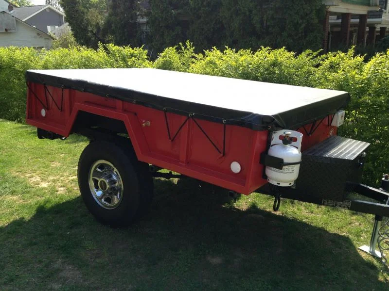

Mark Harley, that is a sweet trailer. That is what I want to complete but to match the FJ45 in color. Nice.

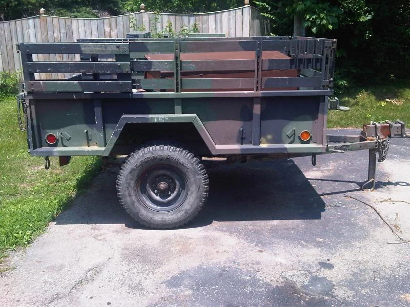

Would you mind sending me the measurements of the areas from a copy of your photo. front corner to front of wheel well, well opening, and from rear of wheel well opening to rear corner of trailer. I believe they are 73" wide. I signed up on Government liquidators and have found several. Some look like they have to be trailered themselves from the lot.
Thanks :beer:
25"-------------34"--------------37"
As the picture sits.
Front of tub to front of wheel well 37"
Wheel well opening 34"
Rear of wheel well to end of tub 25"
Hope this helps, Let me know if you need other measurements.
