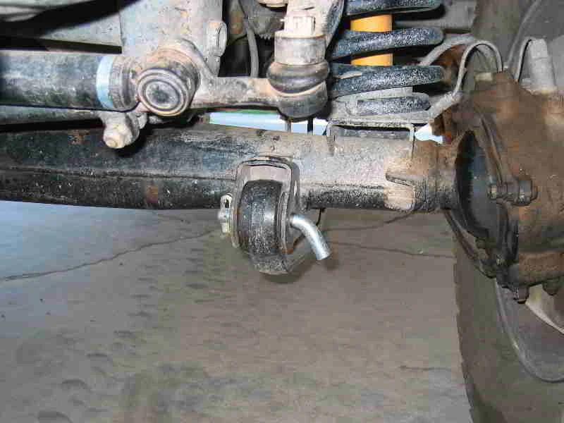

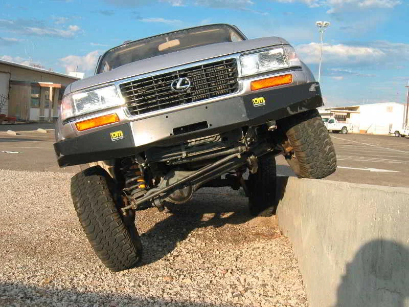

I started a thread a couple of weeks ago asking about using wristed control arms to gain front-end articulation. Just as a little science experiment, I unbolted the forward bolt on the driver's side control arm and took the truck up a ramp. I compared w/ results obtained w/ the control arm bolted. The difference was pretty amazing, as I was able to get full shock extension on the low side w/ simultaneous full stuff to the bump stop on the other. The leading edge of the driver's side control arm -- i.e. the part that was unbolted -- moved surprisingly little, maybe +/- 3/4".
I was concerned about added stress on the passenger-side control arm, which would now carry all the axle torsional loads. Actually, it looks like the weak link would be the mounting bracket vice the arm itself. After reading about Land Rover and Bronco guys doing this (including a ~500-hp Bronco), I decided to test the ghetto wristed control arm on the trail.
The following weekend, my club had a run on a fairly challenging, VERY articulation-intensive trail characterized by a few rock obstacles but mostly deeply rutted climbs and descents. I was originally planning to unbolt the control arm at the trailhead. However, I found that a receiver hitch pin fits perfectly in the bolt hole and was able to simply unpin the control arm while we aired down.
The difference on the trail was amazing. We had a couple of sections where the TJ on 35s behind me almost rolled, and my LX was able to stay fairly level w/ the axles doing all the work. One downside was additional body roll on off-camber sections, but that was to be expected. It seemed as though the front and rear of my truck were fairly balanced articulation-wise. I didn't notice any binding, strange noises, or damage to the control arms or brackets. I'll caveat that with the fact that I tried to be as gentle as possible w/ the truck, especially the skinny pedal, since I didn't know what to expect.

I don't have any quantitative data on shock measurements. However, a while back I marked the max compression/extension points on all my shock bodies w/ a Sharpie. With control arms bolted and no front sway bar, the front shocks are nowhere near their limits (even w/ a rear wheel on the ramp, putting more weight on the front). With one control arm wristed, the extended front shock was at max extension. The compressed front shock was still about 2" - 2.5" from max compression with the bumpstop just touching.
Before and after pics of the stuffed wheel attached.
After pic of the extended wheel. I'm out of space on attachments (150kB max), so I don't have room for the before pic.
Jason

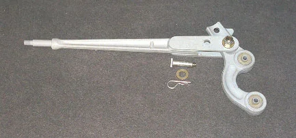

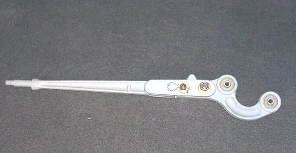

On all the websites I visited, wristing referred to modifying a radius arm to pivot in the x-z plane, where "x" is the longitudinal axis of the truck, and "z" is the vertical axis. Since old Broncos have y-shaped radius arms, they modify one arm w/ a hinge (unbolting one wouldn't work for them). Land Rover guys can simply remove one bolt like us. I've also read about wristed axle housings, which achieve the same effect, though with a lot more complexity.

I really like the idea of the hitch pin over the elaborate Rover deal. The Rover solution won't hold the axle in alignment to the frame. As that wrist rotates the axle moves backwards while with the simple hitch pin on the front the rear bushing holds the axle more accurately in place.
