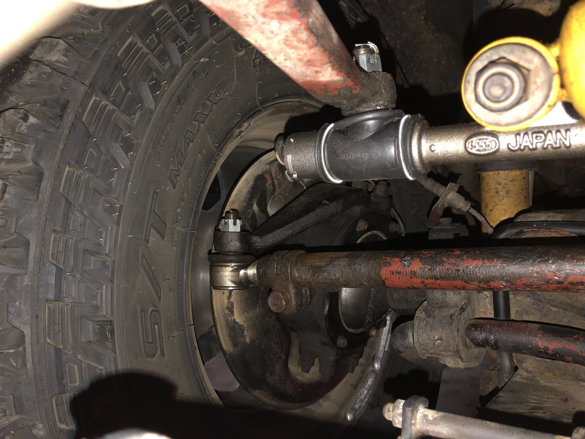

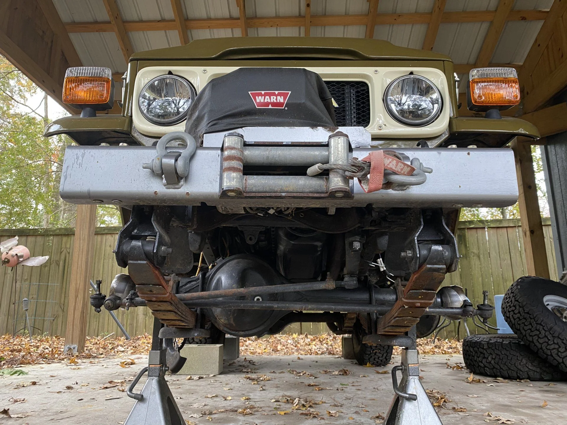

Today was tie rod and drag link replacement day on the Troopy. Got new parts from Kurt at Cruiser Outfitters
Next up is 55 3FE manifold swap and front axle rebuild.

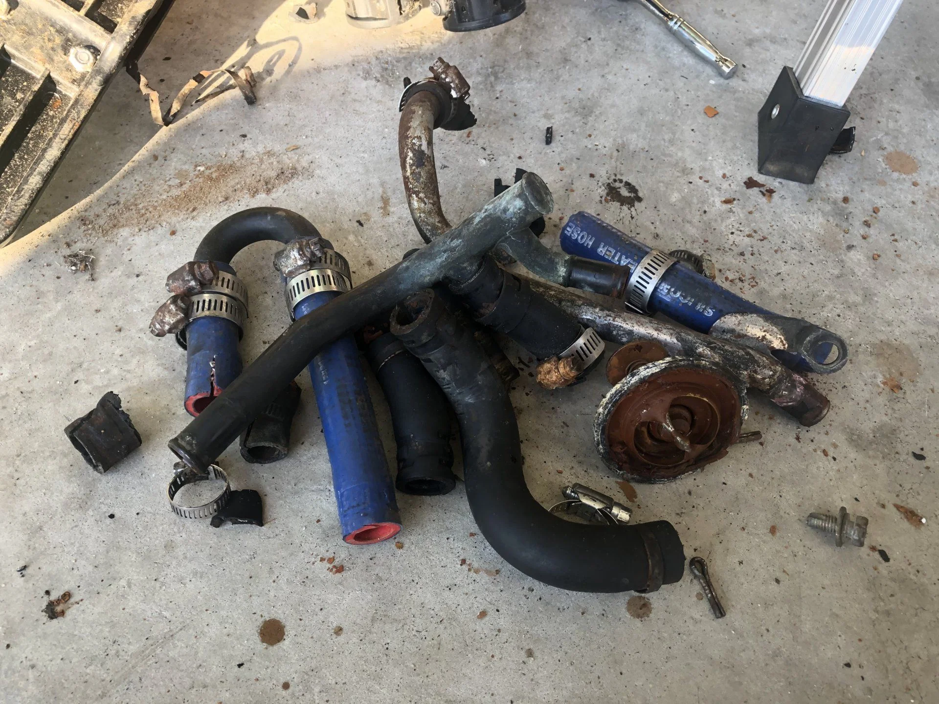

My PHH decided to give up the ghost a few days ago. Thankfully it happened close to the house and I was able to limp the rig home. Decided it was a good time to clean up the coolant system. Got everything pulled today and just waiting for the new parts to show up.
Doing the PHH bypass, rear heater bypass and new t-stat.
You might want to order some proper clamps, also. I don’t think Mr Toyota used hose clamps. Good luck with the service !
I do have some proper clamps coming as well. Let’s just say the previous owner made some questionable maintenance choices.

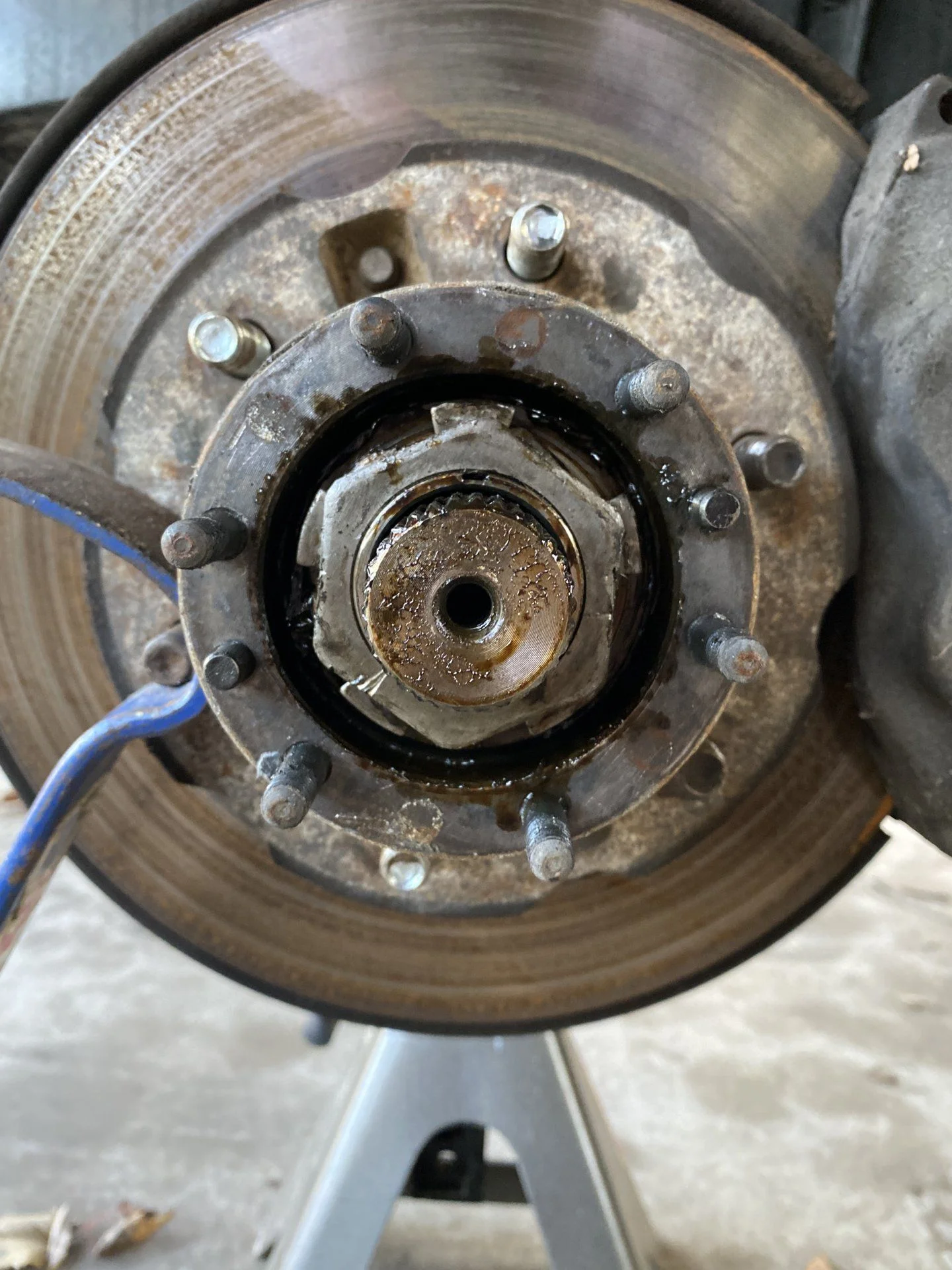

Removed the knuckles to replace axle seals, bearings, and general maintenance since I wasn’t sure when it was last done... And the seals were leaking... And the DS wheel had excess play top to bottom. Among the stuff I found wrong: no LocTite on knuckle/hub studs so some of them came out, no grease in Warn hubs, the axle lock washers were installed but none of the flanges were bent (unsurprisingly, there was no torque on the hub nuts), and suspiciously, all of the shim locations were exactly the same size - which explains the play in the left knuckle and why the right knuckle took more force to move.
Anyone have a knuckle centering tool? If not, I propose the club spring for the purchase because it’s not the first time someone has needed it!
I dont have an issue buying one.
We just have to secure funds from @TailsWCU

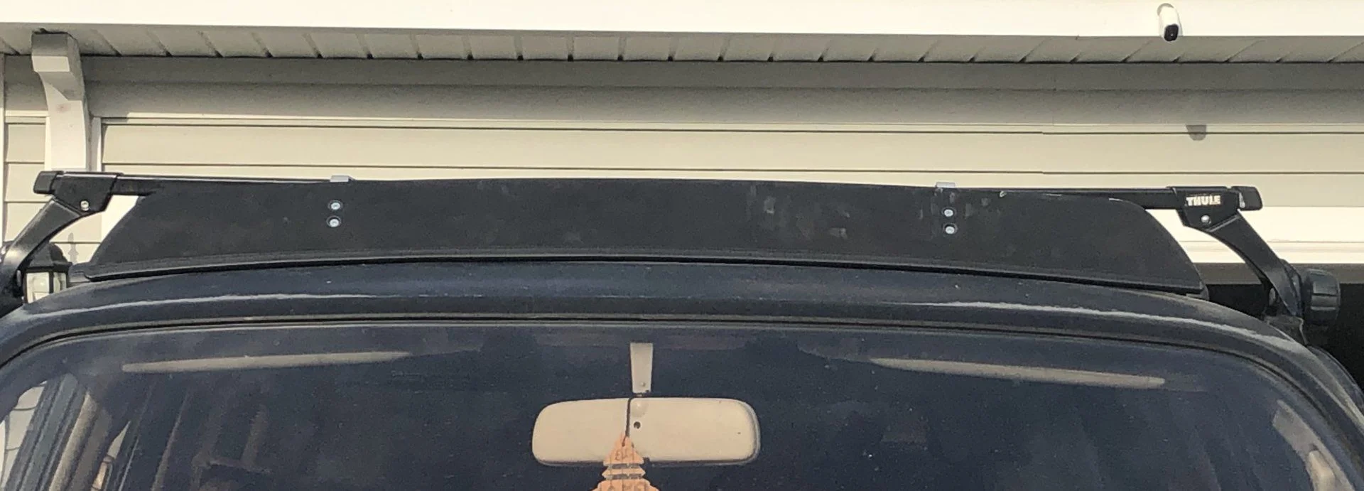

Thanks, you should see all the stuff I didn’t post. Rebuilt my rear parking brakes, rear rotors with pads and calipers. New battery, new upgraded power wiring, removed the factory roof rack, etc.
Looks good, get a Thule sticker and no one would know the difference
Youll be assimilated easily into the TLC locals

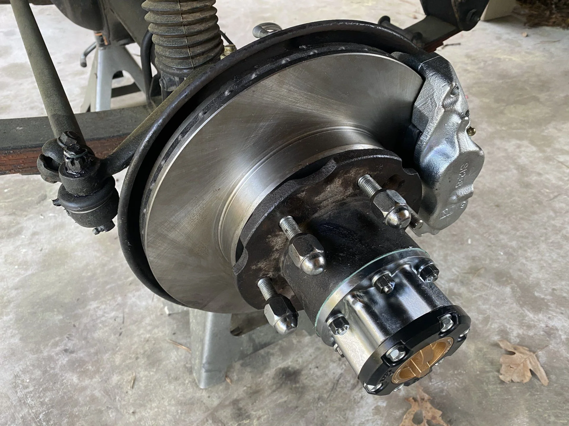

Finally finished! Replaced the following:
New stainless brake lines
New axle seals
New knuckle seals
New trunnion and wheel bearings
New calipers/rotors/pads
New TRE boots/clips
New Aisin hubs
New hub/knuckle studs
New Wheel lugs
Just in time for the relic run, right??
