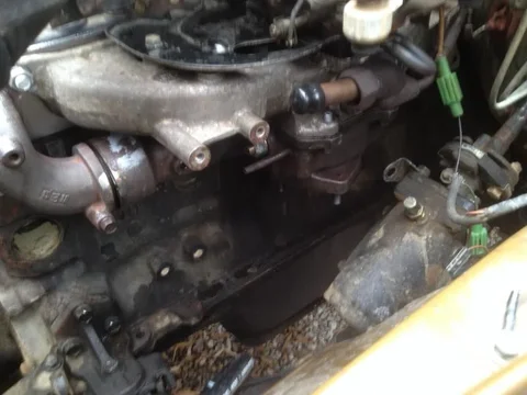

New manifolds in

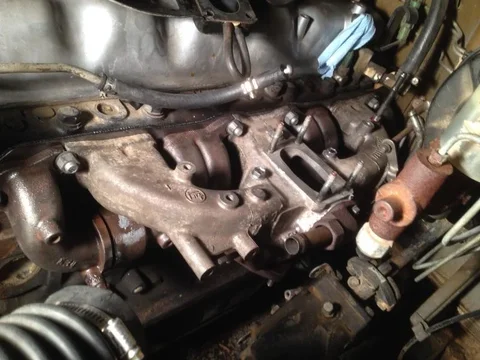

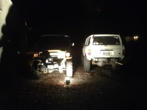

Our work area....
All done-waiting on the down pipe
