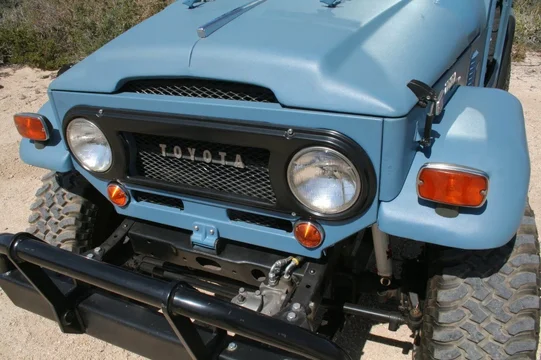

I bought the shackle pivot reversal kit, and couldnt re-mount my stock bumper.
Changing the front shackle , so it flexes to the rear is a dream ride on dirt and washboard.
didn't screw up the alignment too much, and they are greaseable.
Leveled out the 60 a bit too....
You can reattach the bumper mounts and elongate the holes to match the stock bumper on
either the 40 or 60
