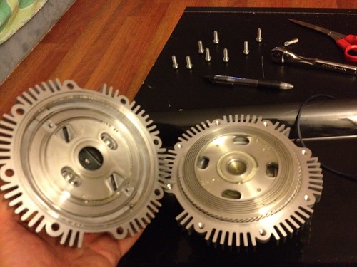

Do I just refill those 4 holes on the right unit?
Untitled by KChan156, on Flickr
I just did mine with 20K CST, filled the four holes on the right of your picture, to the very top of the hole, overflowing the hole slightly. It took about 40ml. I was trying to get 45ml into it, as I belive that is what landtank puts in his. Anyway, she is roaring now. I have never seen the temp this low. 183* on an 85* afternoon, aircon on full cold. :hillbilly:
