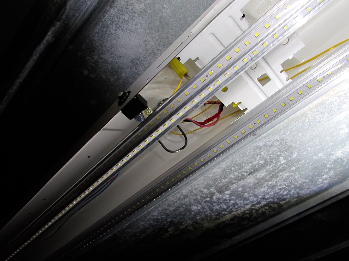

Over the past year, I've been having some issues with the fluorescent lights I installed over twenty years ago. Not only were bulbs burning out, but the ballasts were starting to go as well. At the time they were installed, the F96T12HO fixtures with 110W Cool White 6500K T12 bulbs were a pretty decent deal - providing bright light and not affected by winter temperatures in an unheated garage. Since then T8s and T5s have replaced a lot of the T12 applications and LED lighting is becoming cost effective.
I looked at a number of options. There are quite a few options if I wanted to replace the whole fixture - ranging from about $40 (in most cases, the cost of two 4' fixtures to replace one 8' fixture) to $120 or more. To me, it seemed like a lot of extra work including possible rewiring to accommodate a new configuration. With that in mind, I looked at options to use the existing fixtures. New "plug-n-play" LED bulbs would require ballasts to be replaced, so the cost was about $37 for bulbs and ballast per fixture. New T12 bulbs and ballasts would be about $32-$35 per fixture. And "ballast bypass" LED bulbs was about right in the middle at $35. So there wasn't a clear cost savings with any of the options.
In the end, I decided to go with the ballast bypass option in a 90W Cool White 6500K LED bulb. Even non-PCB ballasts need to be properly disposed of, so there would be an eventual cost to dispose of the replacements and I figured it was better to not need them. I ended up spending a bit more because I added a circuit breaker to each fixture as the bulbs were using much less than the ballasts and concerns were raised about the tombstones not being able to handle the full 15A 120V line voltage if something went wrong.
Having a metal ceiling helped when you can't have the ceiling lights on because you're working on the ceiling lights. A couple HF Braun magnetic work lights worked nicely for the task. ;)
Here you can see the circuit breaker wired into the incoming line.
And with everything back in place you can see how much more yellow the fluorescent fixture to the left is compared to the new LED on the right despite both being 6500K. I will admit that after twenty years, the fluorescents obviously aren't as bright as they once were.
A lot of reviews were saying how these were so much brighter than the fluorescents that people were only putting one LED bulb in a fixture to replace two bulb fluorescents. Despite it being brighter, it is not so bright that I'd consider removing a bulb.
Now I just have to go through and do all the other fixtures.
