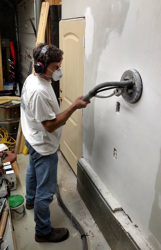

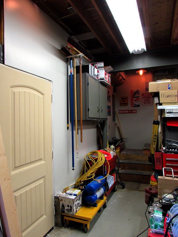

With the warmer weather and a bit of extra time, I finally got the interior wall of the original shop buttoned back up.
With the column being a bit “thicker” than a 2x4, I butted 1/2” drywall up to either side of it (the original drywall is all 5/8”), fastened expanded metal lath over it and the column, and then plastered over everything to blend it all in. It did make for more sanding, but fortunately I have a Porter Cable drywall sander in my arsenal. After the primer and paint dried, I hung the storage cabinet back up and got things a bit more organized once again.
