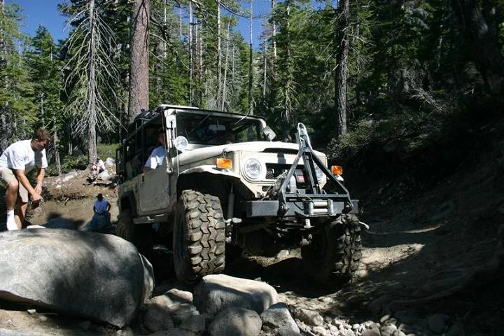

Bought in 1998 off of the Diablo Dealer. Managed to buy it minutes before fellow member Andy Plaine, after he posted it to the old LCML. Had the F, stock 3spd, and long jumpseats.
I primarily take this up on Rubicon, specifically for Rubithon. I’ve attended Rubithon for 9 years now, and am now the Cooking Committee. I’ve worked towards carrying less, as those who know me, know that I use to carry way too much. The ARB fridge has helped that greatly, but so has building and knowing the cruiser.

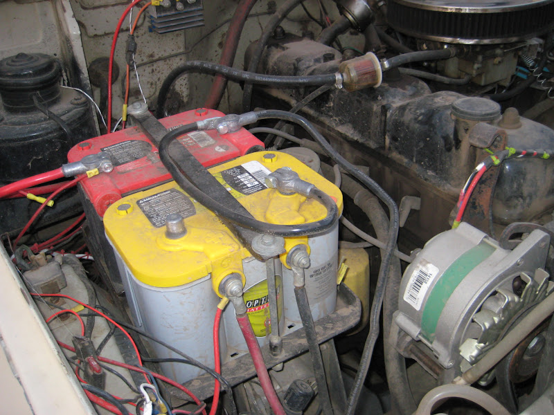

Butch built the seat platform and the dual Optima mount.

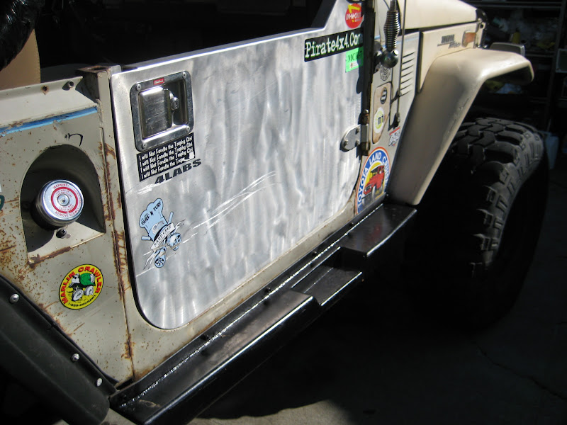

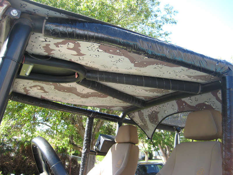

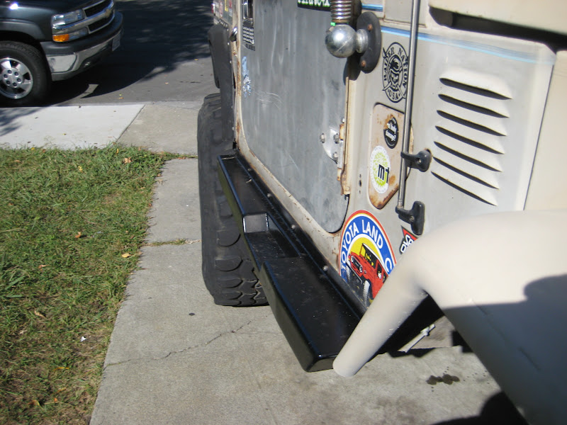

Paul Decker
After Butch’s passing, Paul Decker stepped in to provide the sliders, based on Butch’s original designs.
These are more than just a 2x6 box. If you look close, you can see a bend near the front, which I think is key to the aesthetics of the design.

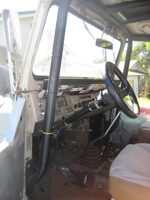

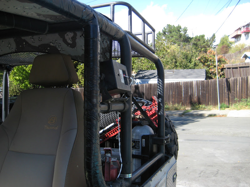

Paul also built the family cage, which incorporates additional “noggin” protection with a forward “J” loop.

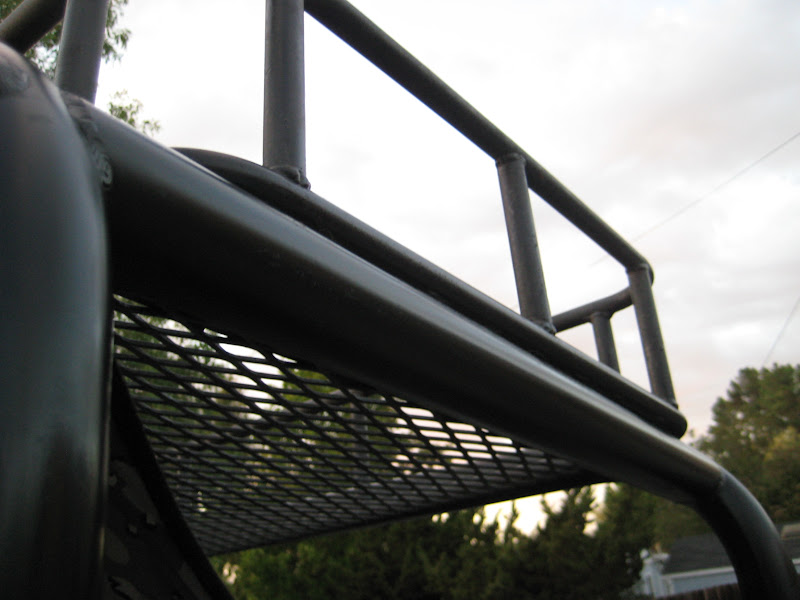

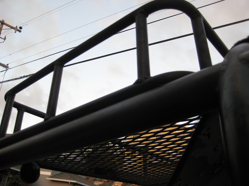

The rear basket is also built by Paul.

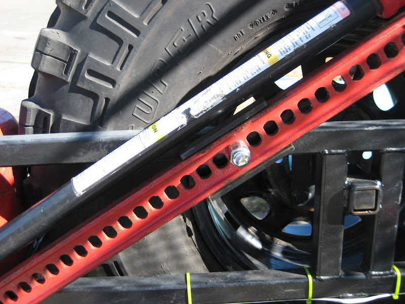

Luke up at 4x4 Labs provided a couple of upgrades for me – a very simple HiLift mount, so that I could carry a 5 footer (piece of square tubing cut in half, with a stud welded to it)

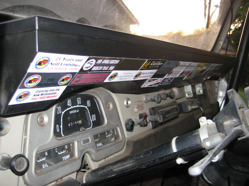

The dashbox was one of the first mods, done by the original makers of the dashbox at the PMC swap meet in 1998

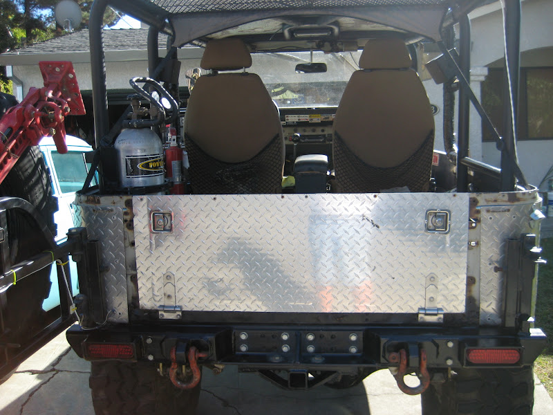

At my first Rubithon, I won a Power Tank, as well as a $350 Aqualu gift certificate, and wound up getting a set of half doors, and their rear storage tailgate:
Sweet Rig. Makes me want to find another 40 and build it. I love the tailgate!
Thanks guys... I was most disappointed in not having the original tailgate, but have been very happy with the Aqualu set up.

You have a stepladder???
Yup -- It's tough getting to the top of that basket, and depending on where we stop, it helps with access to the ARB.
I get as many "That's a great idea" as I do laughs ... But it's all fine.
