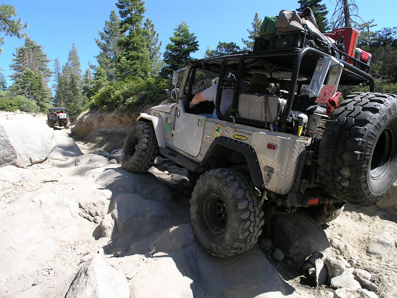

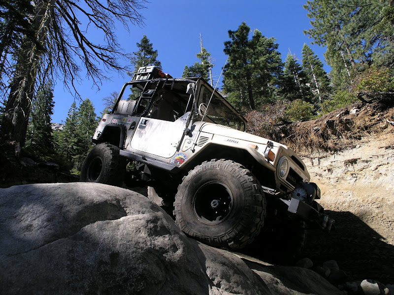

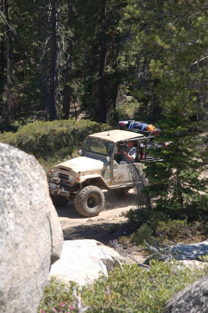

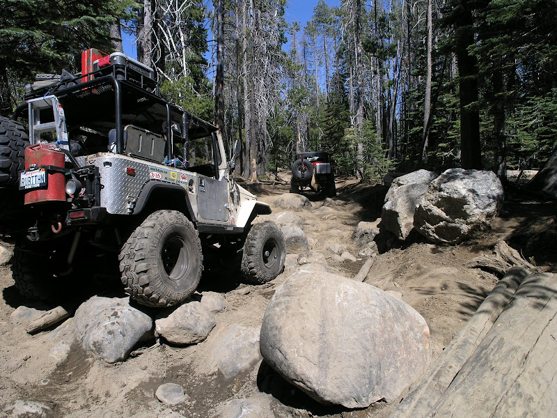

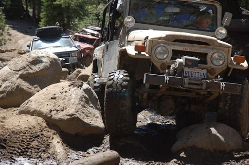

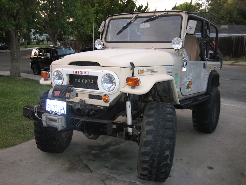

History
Bought in 1998 off of the Diablo Dealer. Managed to buy it minutes before fellow member Andy Plaine, after he posted it to the old LCML. Had the F, stock 3spd, and long jumpseats.
I primarily take this up on Rubicon, specifically for Rubithon. I’ve attended Rubithon for 9 years now, and am now the Cooking Committee. I’ve worked towards carrying less, as those who know me, know that I use to carry way too much. The ARB fridge has helped that greatly, but so has building and knowing the cruiser.
All of the fabrication work has been performed by local fabricators.
Mudrak

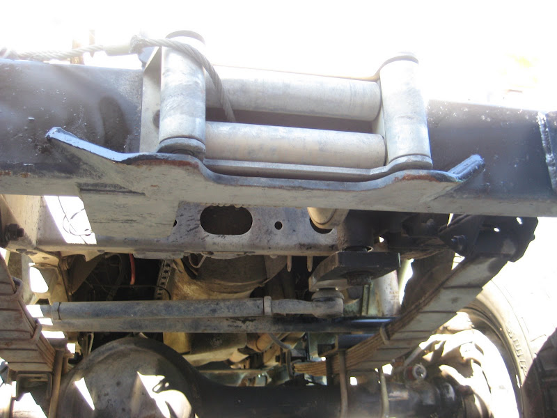

Gary Kardum at Mudrak Custom Cruisers has done most of the mechanical upgrades, including the Spring Over and Shackle Reversal, as well as the SM420 and the Orion install. Gary used Butch’s power steering plates, which include a 1” frame extension, and extra plating on all sides. This has helped prevent any of the frame tearing that so often occurred. They have a triangular plate that allows the bumper to become the new frame crossmember. Gary did the rear frame repair, and installed the OME Heavies.
Butch Lewis
Butch Lewis built the front bumper, which included the roller fairlead protection, as well as the winch motor protection.
Butch built the seat platform and the dual Optima mount.
Paul Decker

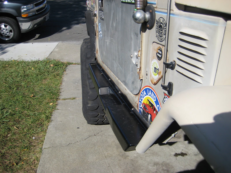

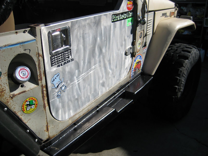

After Butch’s passing, Paul Decker stepped in to provide the sliders, based on Butch’s original designs.
These are more than just a 2x6 box. If you look close, you can see a bend near the front, which I think is key to the aesthetics of the design.

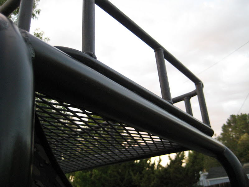

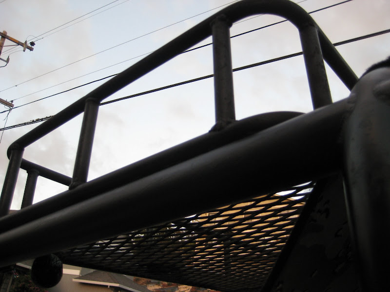

Paul also built the family cage, which incorporates additional “noggin” protection with a forward “J” loop.
The rear basket is also built by Paul.
4x4 Labs
Luke up at 4x4 Labs provided a couple of upgrades for me – a very simple HiLift mount, so that I could carry a 5 footer (piece of square tubing cut in half, with a stud welded to it)
He also put some tubing for the fender edging, as I was always pulling the lip in.
Before:
attachment.php
After:
Others
The rear bumper and swing out was built by Stout Equipment, which closed their doors years ago. I’ve been pretty happy with their bumper, which has held up to the abuse fairly well.
The dashbox was one of the first mods, done by the original makers of the dashbox at the PMC swap meet in 1998
I’ve done most of the other work, including the 2f install 2 days before Rubithon. I’ve done the mechanical work, including the ARB, the powertrax, the disc brake conversion front and rear, the wiring (which needs to be overhauled), and most of the maintenance.
At my first Rubithon, I won a Power Tank, as well as a $350 Aqualu gift certificate, and wound up getting a set of half doors, and their rear storage tailgate:
Thanks guys... I was most disappointed in not having the original tailgate, but have been very happy with the Aqualu set up.
"classic Mods" is kind of funny, we were talking about that earlier this year on a run... It seems like more and more rigs are getting linked, and running Danas... I've been pretty happy with this set up (knock on wood).
