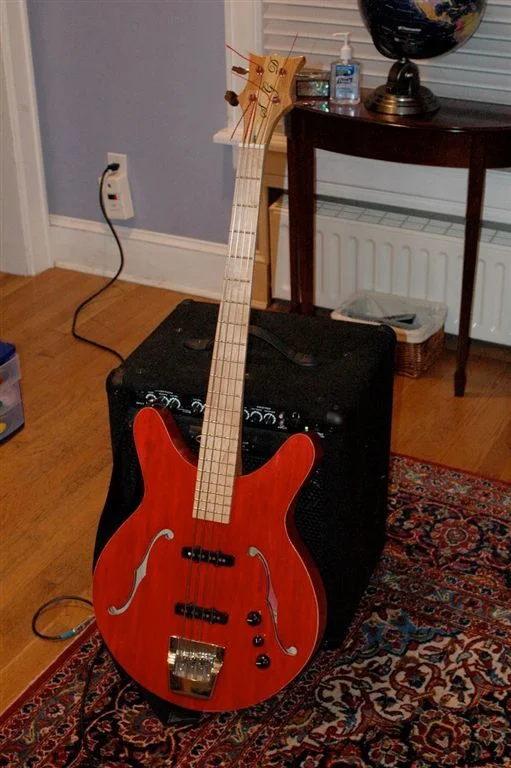

made this bass for my kid..shaped the neck with a lee valley spokeshave
