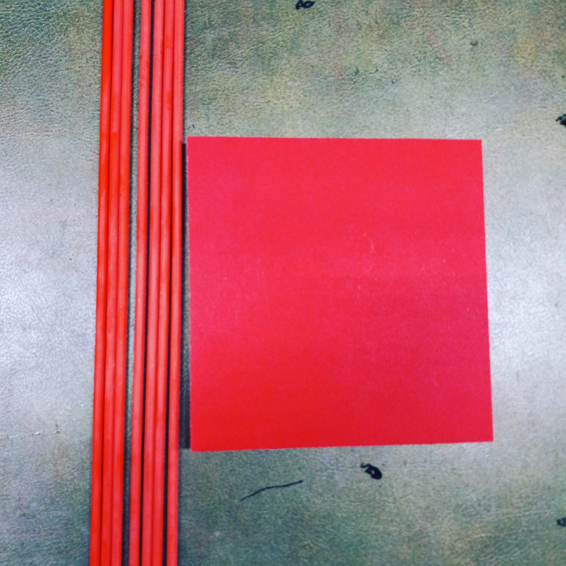

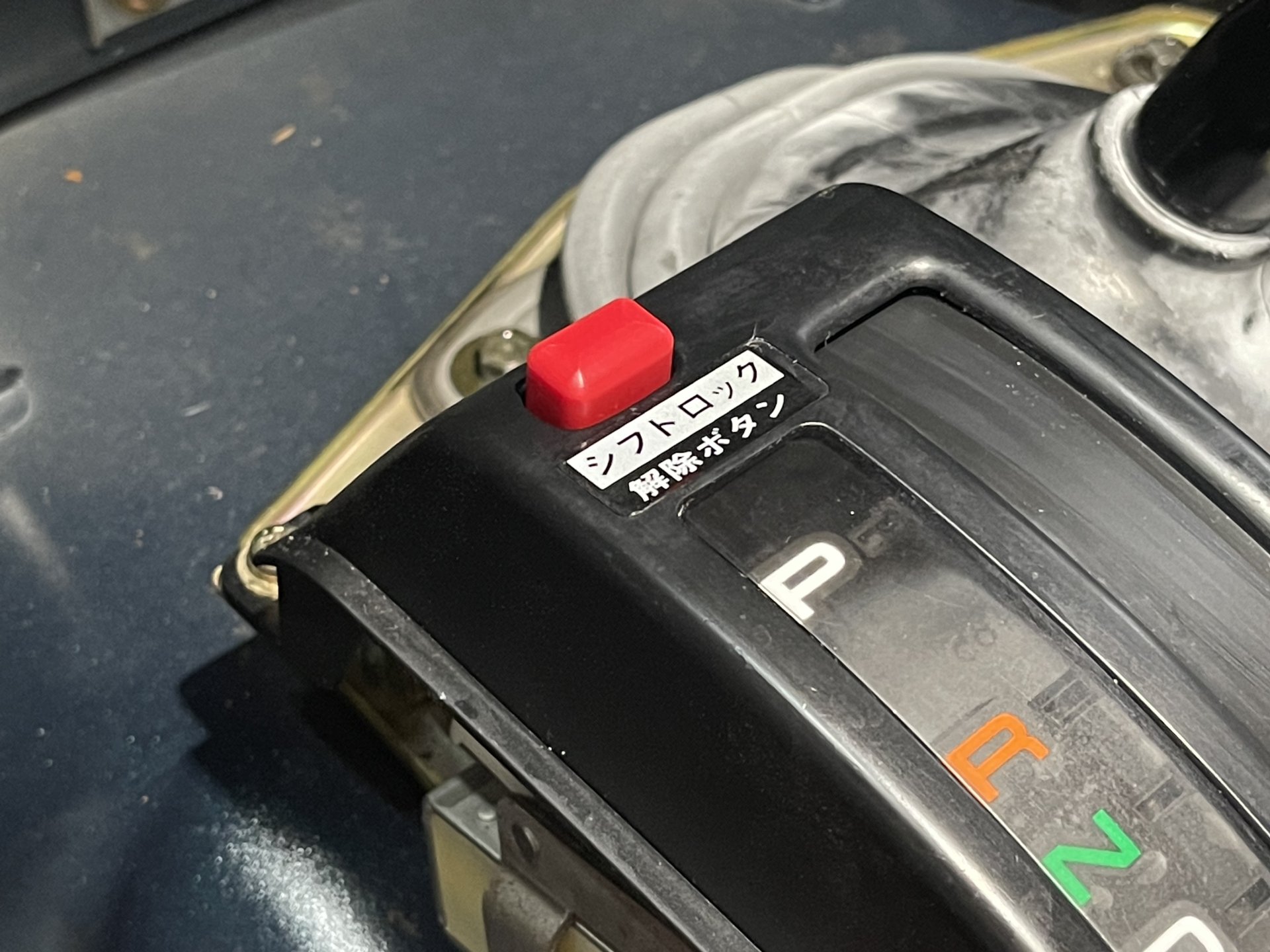

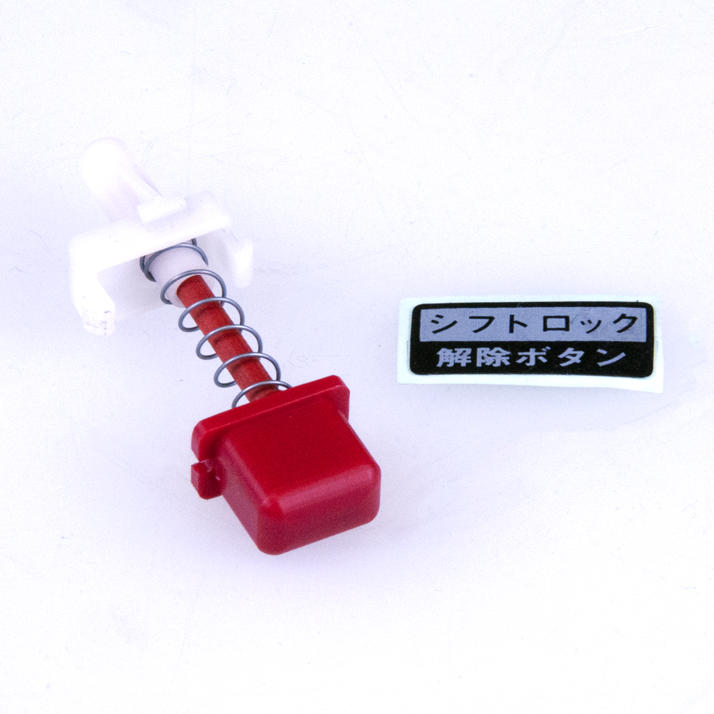

Did you know that early 80Series got a black shift lock button on the shifter console? Cool right? The later 80s were denied. Did you know that the JDM 80s not only came with the button but they are RED?! Yeah thats not fair. So we went ahead and machined a new button from red Delrin and pressed in a red Garolite machined shaft so that we had the components needed to add the shift lock button to your 80 with JDM flair.
Why add the button? So that you don't risk losing the little cap AND so you don't have to hunt around to find something long and skinny to stick in there to activate the shift lock. If you've ever worked on your dash or your carpet then you can already visualize how freaking cool this is.
