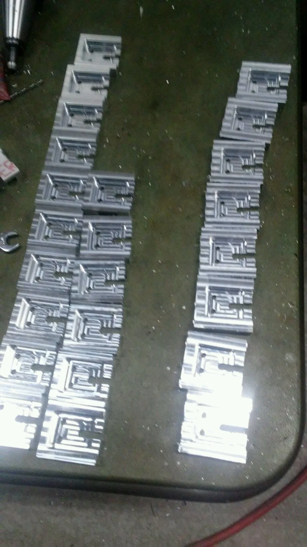

All of the 60series mirror arms should have all been delivered by now. Hopefully ALL of you have gleefully installed yours already. Please post up pics and please let me know of any changes I should consider and mounting options you'd like to see.

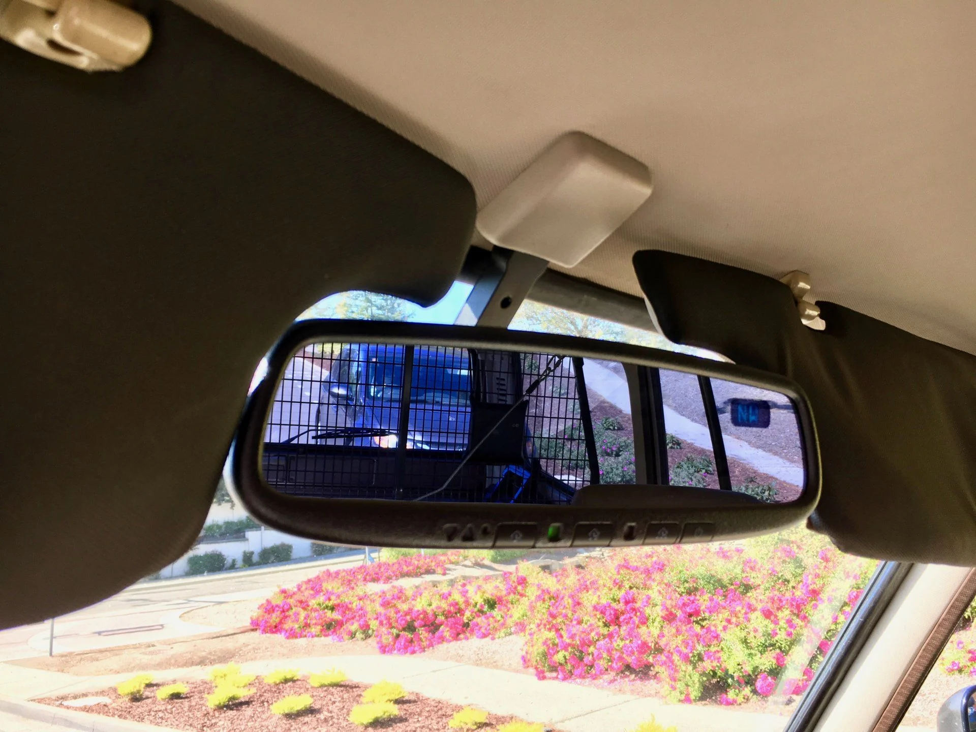

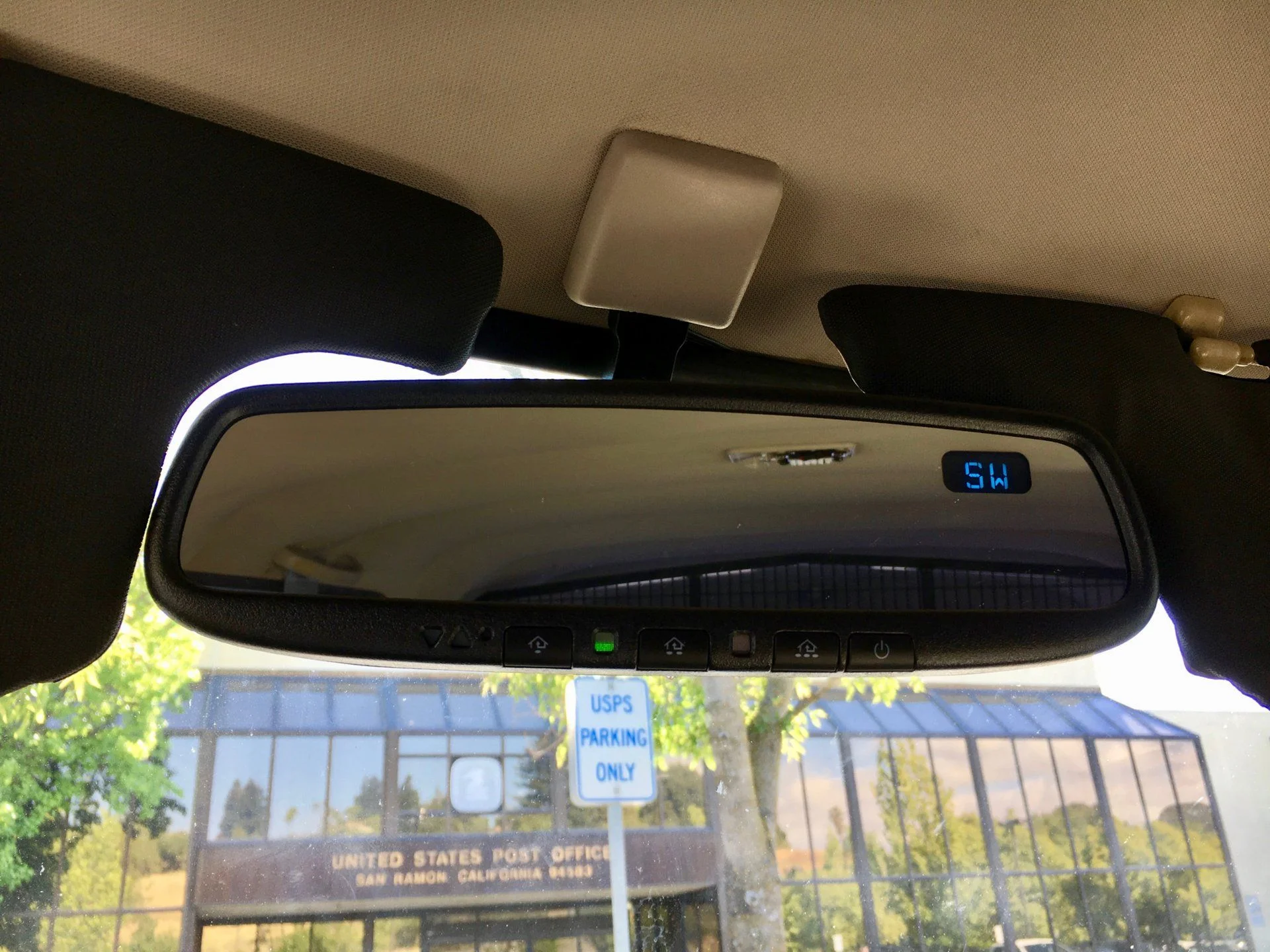

I got my new Gentex mirror installed today. A major improvement over the 33 year old stock unit. The installation was simple; NLXTACY's mounting bracket worked perfectly. At first, the drivers side sun visor was hitting the mirror , but I loosened the mounting screw on the sun visor and was able to move it over just enough to clear. I used a Gentex, flat power cable, which I was able to slip under the windshield rubber seal, then down the A pillar.
How did you run the electrical? Close up pix?
