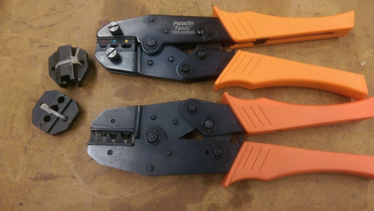

This is what a decent set of ratcheting crimping pliers looks like:
Paladin 1300 crimper with swappable dies. I have a set setup for both insulated (#PA2040) and uninsulated (#PA2031) terminals. They work awesome and will make a crimp that looks OEM.
I did a bunch of wiring in my pickup last year when I was putting the interior back together, adding power windows, locks, keyless entry, several other accessories, required a lot of crimps and hundreds of zip ties. So I did the research and made the investment, well worth it. I also have dies for coax (#PA2034) and putting RJ45's on twisted pair (#PA2061). Found everything on Amazon.

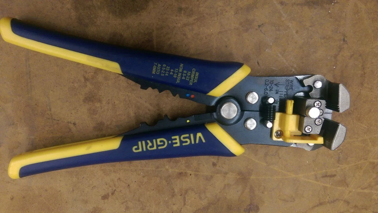

My new favorite stripping pliers as well:
<snip>

I use the same type, they work great for me but I think the Paladen ratcheting type are better for the occasional/ novice user.
In a production environment the ratcheting style are most common because they rely more on the tool than the operator to make a repeatable crimp.
