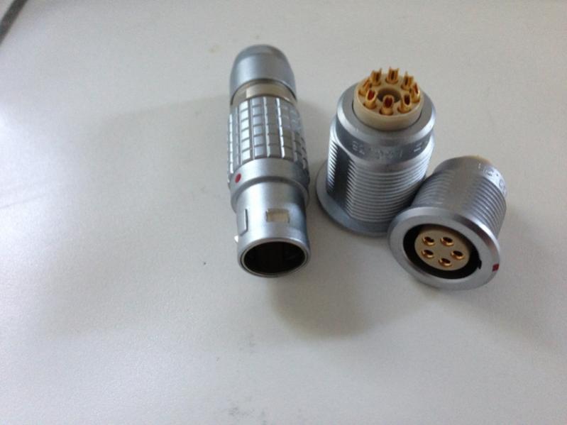

Ok so I have a thought about what do use for the power connector. LEMO.
The same one is rated to 10A and the larger one is rated to 15A. The two smaller are bulkhead connectors while the longer one is the matching cable connecting side.
Once connected it is NOT coming out. You have to pull back the sleeve to get it to unlock before you can pull the connector out.
