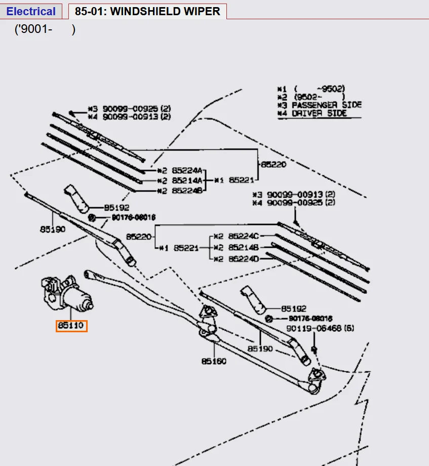

Looking for the part number of the 4 bolts that hold the wiper motor but can't find it in the EPC.
Seems like they are included in the wiper motor assembly and not listed separately. Anybody knows the number or a suitable alternative?

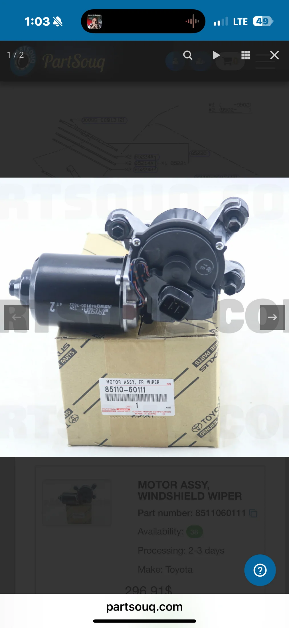

Looks like they come with it.
M6x1.0x25mm just pulled one of my truck and measured.
Looks like it’s a pretty specific bolt combo with a built in sleeve. I would look in the parting out section classified. @swamp-thing will have them.
