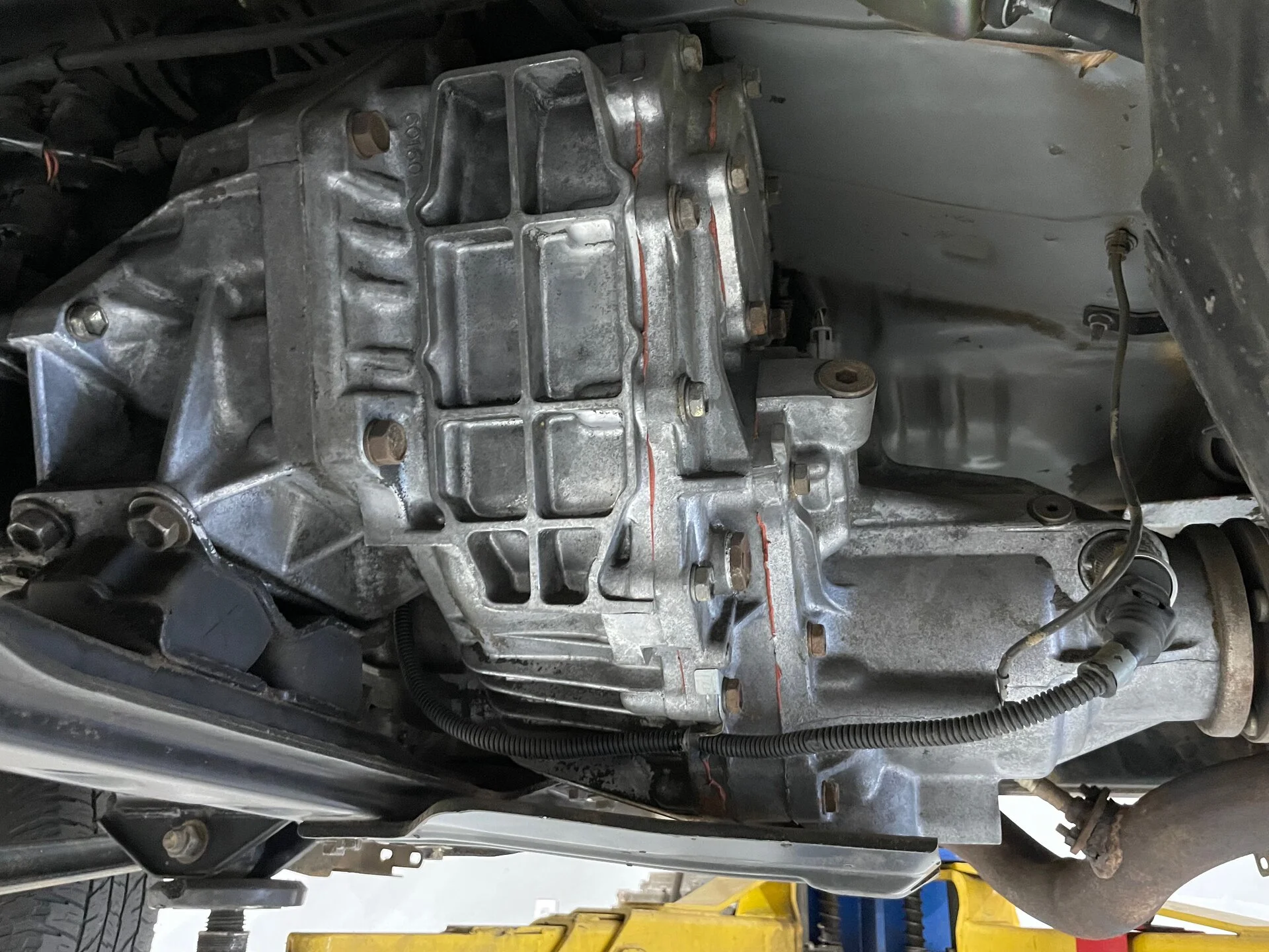

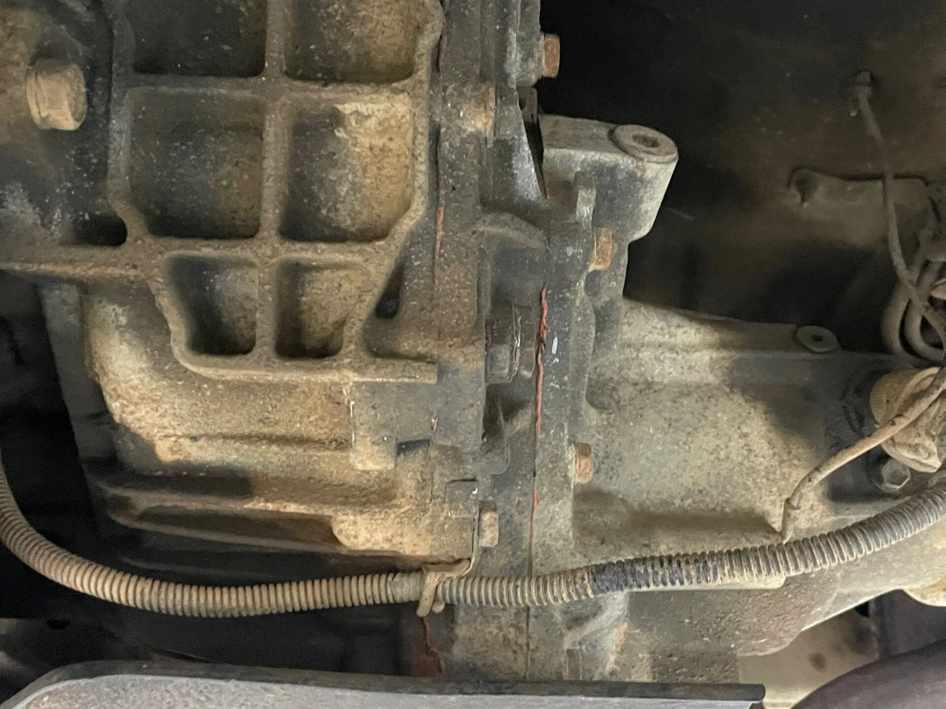

Also went to this guy Mark’s shop @ Performance Automotive on Dickens yesterday to check out his dry ice machine handiwork. Amazing results.
Don’t think i’ll actually be pulling anything til March, but I will keep you all posted. And if anyone is in need of a well worn 4spd transmission or a fzfe core, let me know.
