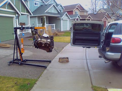

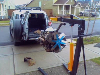

I guess I'll chime in! For the last 8 months I really haven't done much to my cruiser. For some reason, I had a sudden burst of energy to start working on it again, plus I got a really good tax return which is funding some new projects.
A couple weeks ago I bought a new engine from one of the cruiserheads up here in Seattle. Amazingly, I was able to shoehorn it in the back of my FJ Cruiser (it was a delicate process)
Last summer I took the heater out and bought cheap caps to plug the holes. They ended up popping and I overheated the motor pretty good, now it burns coolant like a mofo. So I'm performing my first transplant. I'm also dropping in a SM465.
Here is another one:
