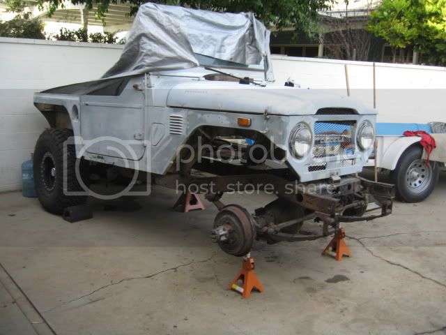

this winter? Im doing a pretty much full build up. I got this 72 not to long ago. and its pretty much stripped right now. Plan on getting my engine drive tran. and mocking it up. And make my 77 more street friendly
Eric
