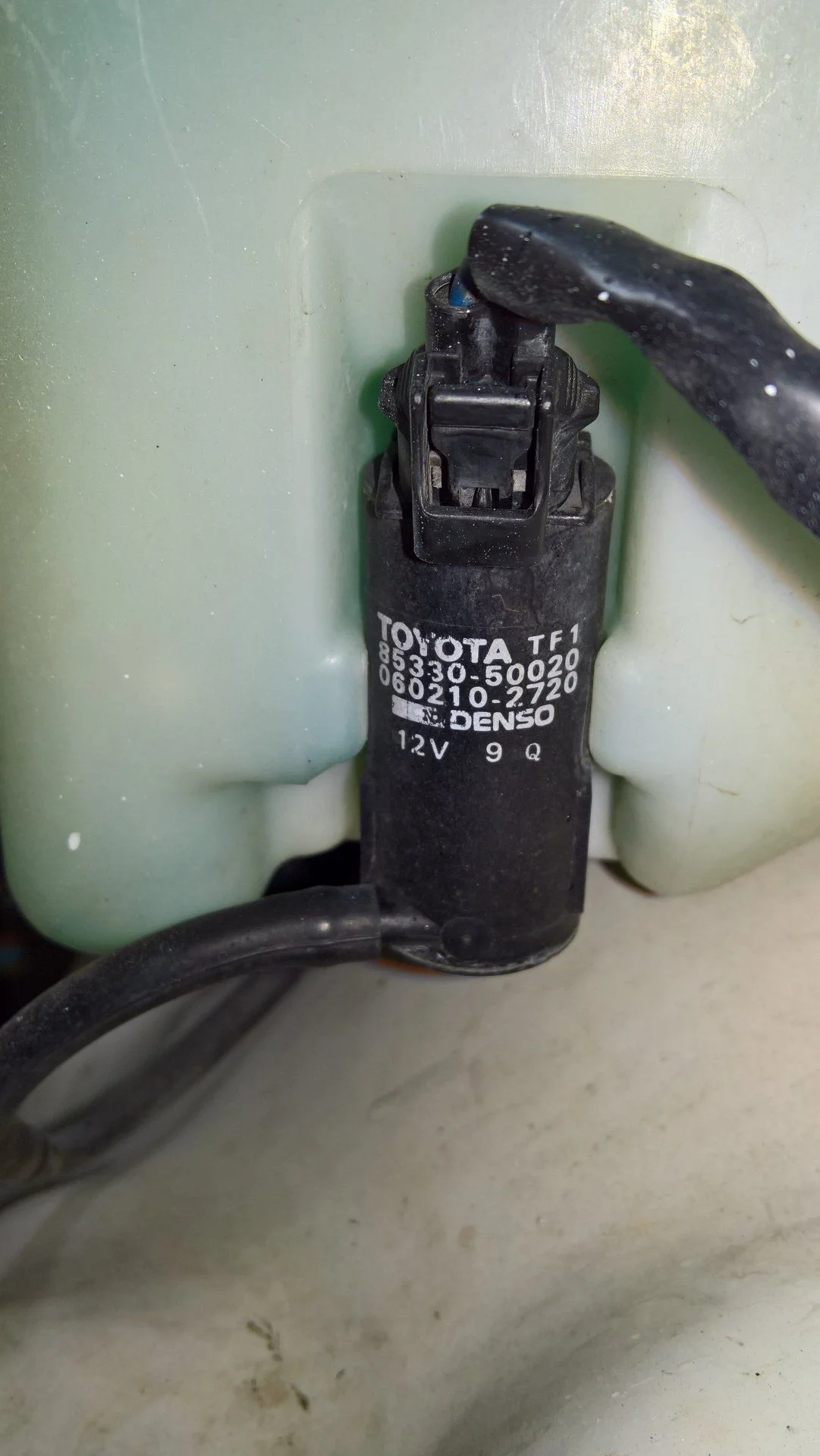

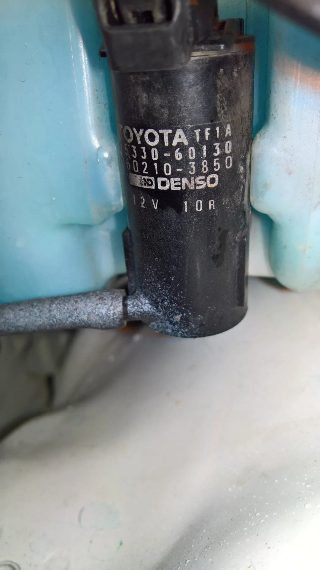

Bringing this back as I'm about to order a new washer pump, however I find different part numbers for the windshield washer pump: To 5/96 shows as 85330-50020 amd From 5/96 as 85330-60130. Both parts appear to still be available (US spec LHD FZJ80, 1996 and 1997 models).
Looking at the pumps they appear identical. The washer tanks
are the same part (Toyota ASMO 860141-244). Both tanks/pumps
are mounted on the front right inner fender.
The only outward differences I see, besides the part numbers,
is TF1 and 9Q printed on the earlier part and TF1A and 10R
on the later version. So, guessing, the TF1A appears to be an updated version of the same part??
9/95 Production date US spec FZJ80: 85330-50020
Note TF1 and 9Q
11/96 Production date US spec FZJ80: 85330-60130
Note TF1A and 10R

I have the 85330-50020 pump in a (09/95) 96 model FZJ80 and the 85330-60130 in a (11/96) 97 model FZJ80. They both fit, hook up correctly to the factory harness, and seem to work identically.

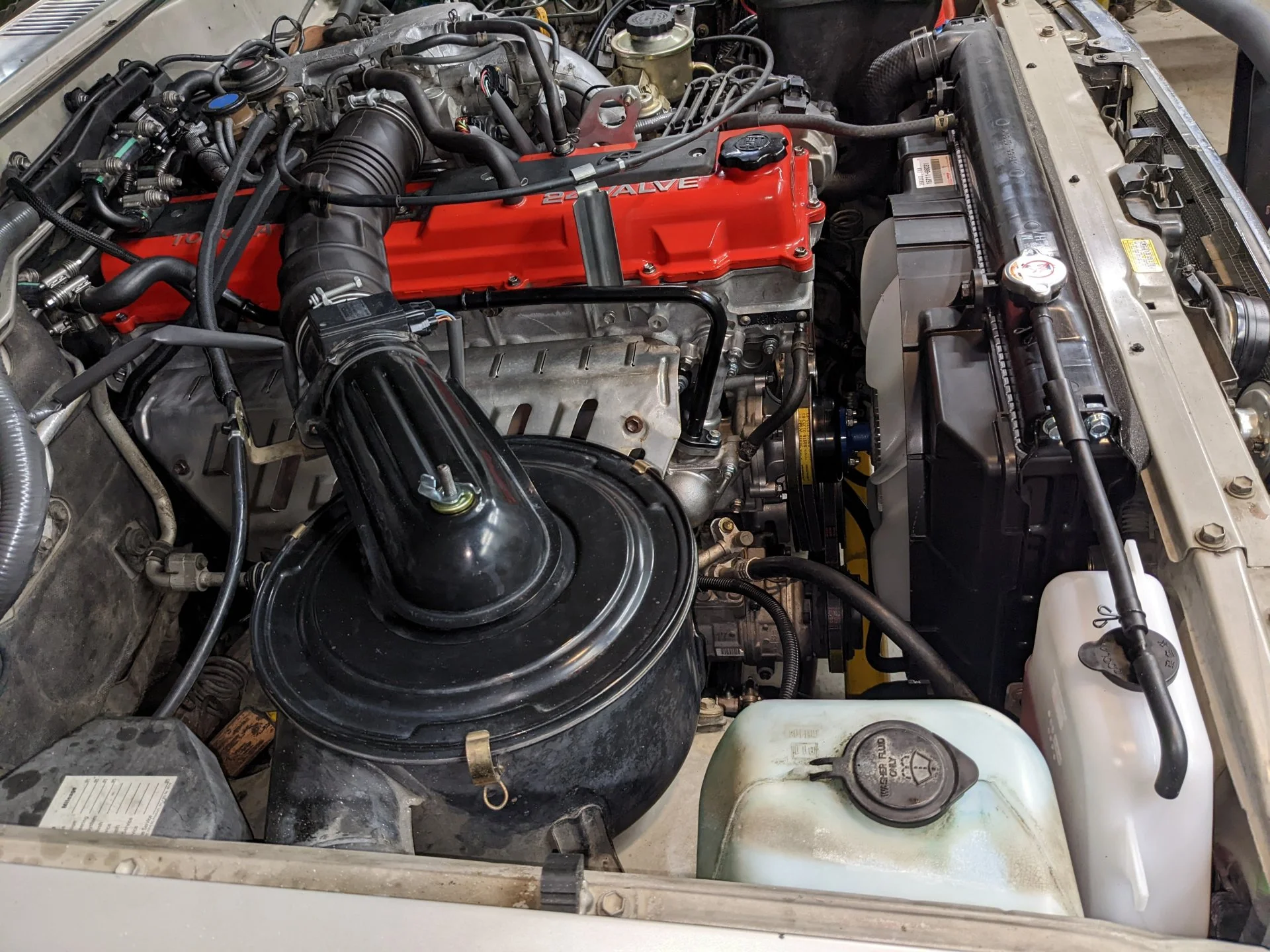

Anyone know where I can find a new 97 FZJ80 washer fluid jar?
I just finished a 1fz refresh and everything else is sparkling :hillbilly:
Mr t says discontinued.
Thanks 🙏
You could try the parting out section in Classifieds
Thanks, mine works fine
I'm looking for shinny factory new.
I want a shiny factory new 80, but I can't find one either ;)
