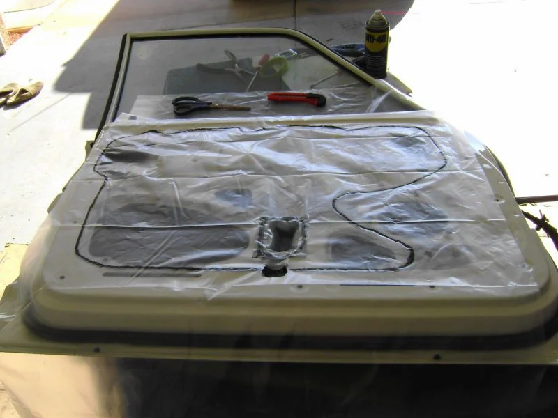

Rob,
To further elaborate, the moisture barrier will look similar to this:
Obviously, I was nearing the end of the replacement process, but imagine it cut to the contour of the line of black sealant.
Rob,
What did you use for plastic and sealant?
Thanks,
Chad
Plastic was just some 2 mil( or thicker I think) drop cloth type stuff I had around, and the sealant was just black RTV adhesive.
Honestly, anything with more substance than a trash bag would do, as it's gonna be always protected w/ the panel.
