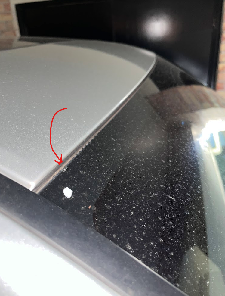

To be clear.... Is there supposed to be a rubber trim piece at the top of the window from left to right or is it supposed to be empty as in my photo below?
Adding to this, I also was surprised by the wind noise. I had a 2018 GX and there was hardly any difference with the shade open, it was fantastic. Disappointed the LX is so "loud" with the shade open.
There is supposed to be a thin rubber strip attached to the back side of the glass that prevents the gap filling with leaves and dirt. It is buried down in there.. not supposed to protrude at all.
I can’t tell from your picture whether it’s there.. need to post something much closer up/zoomed in
