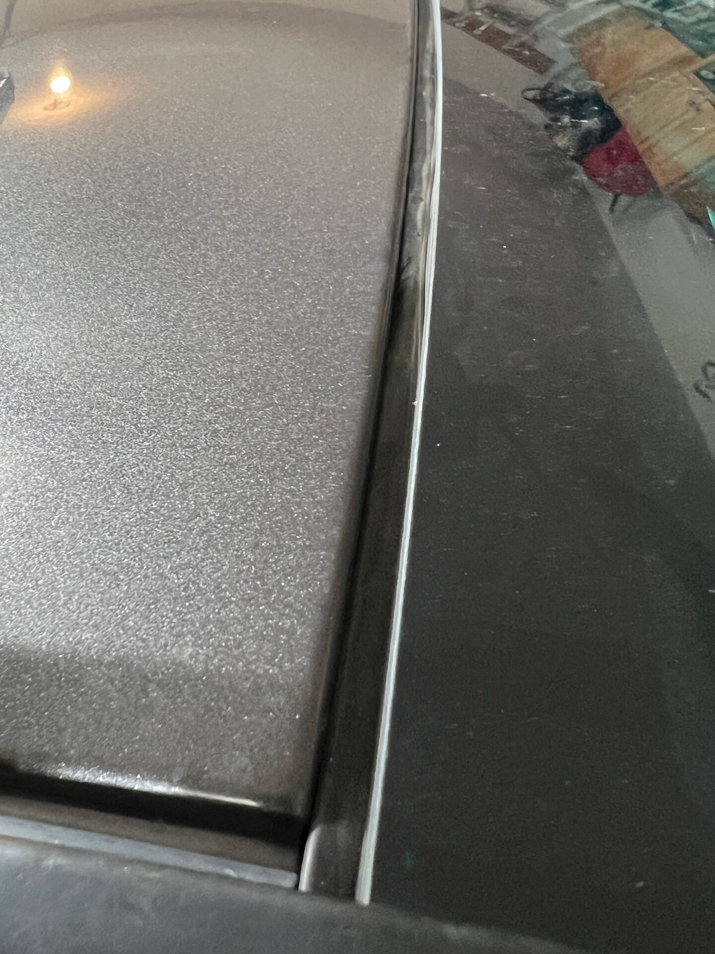

My strip is defintely buried in the 'gap'; not protruding. see pic. Could be the culprit. Not really sure. Can't tell from any stock photos or posted images. And unable to find any associated OEM part #.

For collective benefit, here is a pic of mentioned thin rubbertstrip (gasket?) on my 2011LC. Maybe this is the culprit?

Here are better (hopefully) photos of mine, on a 2013 LX 570. I don't know the history of the window, but it is Lexus glass.
Looks like there is a seal there but it looks different than @berko1's photo. The orange/brown is slim. The back face of the glass is visible.
