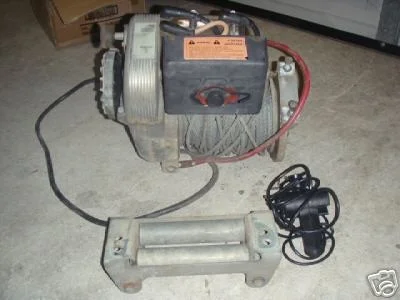

8275
Thanks for the replies! I bit the bullet and bought this winch on ebay. Everything works AOK, and parted around $300 US for it. Now after reading the the article on pirate, I might throw a seal kit in it, and clean it up / powder coat the exterior ect.......:beer:
You got a good deal.I have had the same for a long time and works great.Parts are everywhere and there are a few blokes around that modify the wiinch for comps eg waterproofing.
