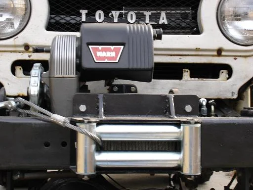

    The 8274-50 just look's right on a Cruiser.
    [​IMG]
    Based on the number I still see in service they hold up well.
