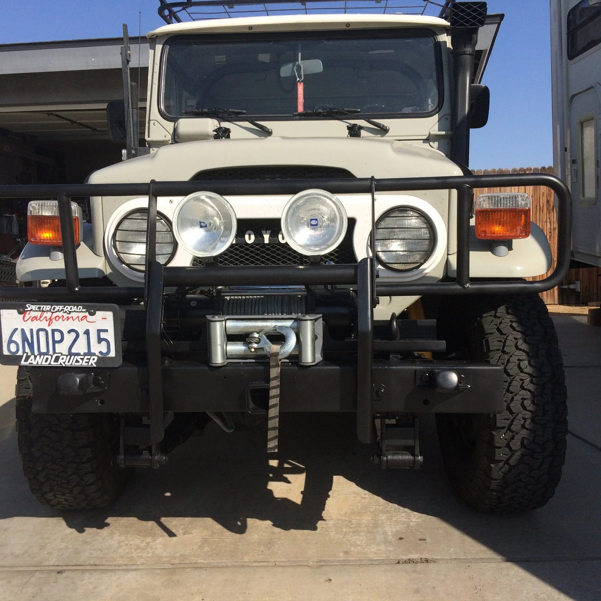

My Badlands 9000. CONTRol box is behind the license plate.
