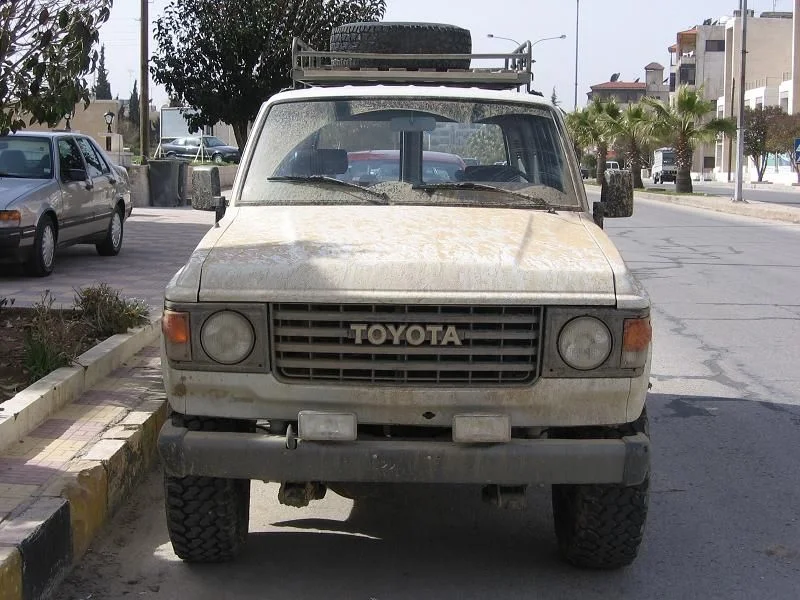

I have my eye on a TJM 8000LBS electric winch and was wondering if anyone installed this thing using the stock bumper. I already bought a brand new front bumper and am willing to cut the old one to shreds if needed. Pic included and comments appreciated.
Really don't think it was designed as a load-bearing bumper.
I'm with Grandpa on this one. You can straighten a bent stock bumper by putting a chain on it and around a tree and backing up. Pretty sure this is a good sign not to mount a winch to it.
You could keep the stock bumper and make a mount for the winch that bolted to the frame and not the bumper. But you cant just mount the winch to the stock bumper.
I have seen this done before and it looks really good. Probably takes some welding skills to hide the bracketry behind the stocker though.
my winch(m12000) is on a mount attached to the frame, the stock bumper was cut to fit on/around the winch mount. i think i may have a pic.
as mentioned above, you cant mount a winch direct on the stock bumper.

Correction
Everyone thought i wanted to bolt the winch directly on the bumper :crybaby:, which wasn't what i meant, but i probably wrongly conveyed the message.
What i want to do is to mount the winch using brackets to the frame, and i need to see how this is done and what needs to be cut from the bumper to accomodate the winch & how far out will the winch protrude.
