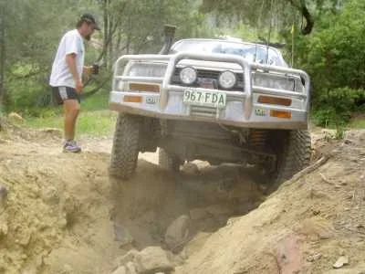

My mate with the alloy barred HDJ80 is currently working away in the mines out west. Next time he comes home on a leave break I'll take some photos for you. He's a boilermaker by trade and made the cradle himself.
Found a pic of his truck but doesn't have the detail you need.
BTW, his is a TJM alloy bar with X9 superwinch.
