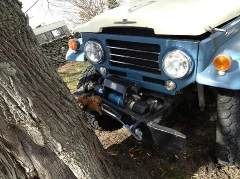

hit at pot hole/bump on a 4 lane road doing 35 and something snapped in the steering, Luckily she just turned right onto the side of the road took out a couple of signs then hit a tree
The frame is buckled in right infron tof the shock mount on the pasenger side and the body is twisted on that side as well. not sure what my next step will be but she is pretty totaled
I walked away with bumps and bruises but ok leg was x rayed but just some deep bone bruises got in trouble for getting Wilma home first before going to the ER, kind of on house arrest now.
Tofally bummed

Wilma can be straightened, does not look so bad...I could do it or any big body shop should be able to pull that frame out easily, body didn't get hit.....buckle should flatten as you pull frame, lmk if I can help

still not positve the cause but it looks like the zerk fitting on the steering shaft blew andthe slip shaft sid off the D shaft not sure cause the engine is now moved over into the steering shaft path so that could have happened after impact. tierods and everything visible seem ok both hubs lock and unlock easily so without going in the hubs appear ok.

so I went the the accident site this morning to take some pics and see what was up. turns out not 50ft from site is the only auto collsion place ont he island that has a machine big enough to do frame pulls. like what would be needed. glad I had it towed home :( he told methat it would be anywhere from 500- to 1200 if it is not compromised to bad, or there is the new frame angle.
got back home and looked wilma over a bit more closely
The body: while it is a bit twisted and funky seems the passenger side pulled up and back an inch the drivers side all looks finethe passenger fenders is tweaked on the inside but that could be pounded out and would not be visable, over all it does not look to hard to straiten it all.
Frame: it worries me a bit
Culprit!!!! the last thing I noticed was that the passenger side motor mount the weld holding the plate to the U channel section that bolts to the frame mount was popped off. this would have allowed the engine to pin the steering shaft,but who knows for sure.

It could have I guess it would explain why the steering locked up in that the engine is now moved over into the steering shaft zone. I don't know, its just one more thing that would need to be fixed.
