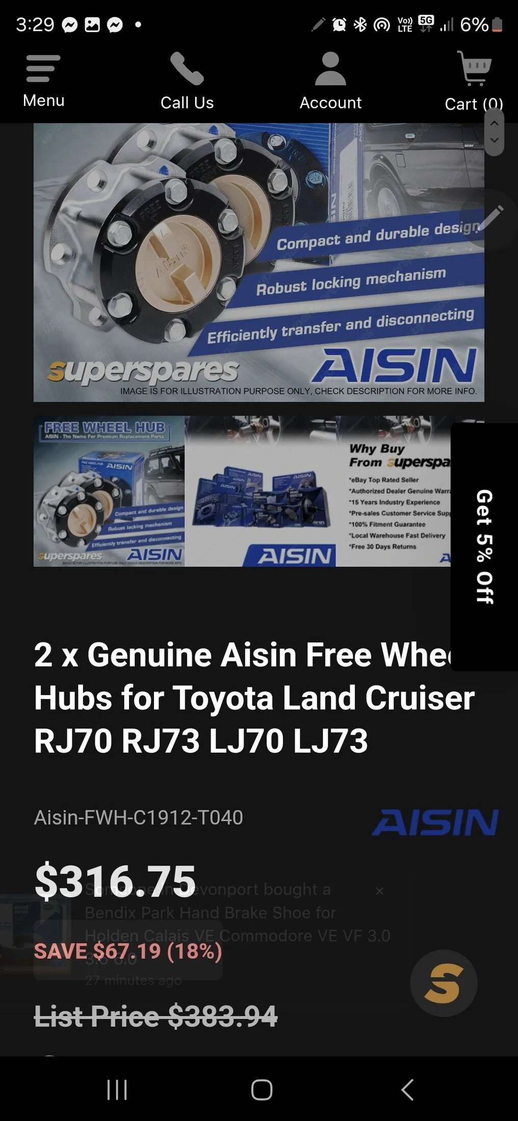

Hey all,
Hoping someone can help me determine if these will fit the LJ78.
Thank you so much
If you currently have electric hubs those won’t work without different spindles and hubs. Search for manual hub conversion here, there are several threads detailing what all is required. I recently purchased a manual hub donor axle and will be converting mine soon.
I am running those on my lj78. I had to get the spacers. Also had to face the cores down a bit to get the snap rings on. Or you can use the cores from your auto hubs. You’ll see what I mean when you install them.
