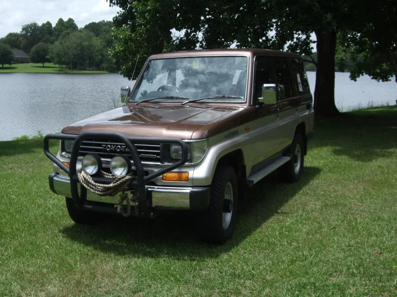

I'm still learning about 70 series frame differences, so hoping for some help here. There is a BJ70 winch bumper for sale somewhat local to me, and I was wondering if it would fit my LJ78. I'm ok with doing some modifications, but am hoping it will at least bolt to the frame horns.
Here is a pic of the bumper in question:
Here is my LJ78 as it is currently:
imshore it can made fit ! as the wide doest differ so some little modifications and good to go !
(will indeed look much better than the current bumper):p
I suggest this "poor man's" winch. You just need 12 large friends that are willing to pull the rope. :)
the LD frame horns are the same width as the HD units but they sit 1" shorter in length.
the fender mounts might or might not be an issue
i could bolt my bumper from my HD 70 onto my LJ78 build but the winch wouldn't clear so i had to change out the frame horns on my applicaion.
width you will be fine, you MIGHT need to modify for length.

Crushers, that is great info, thanks a lot. That is exactly what I was looking for.
I'm going to contact the seller and check out the bumper in person.
