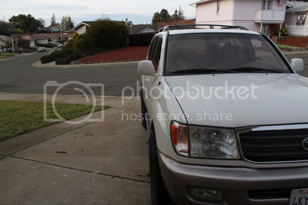

Ill try and get more pics when the light is better.

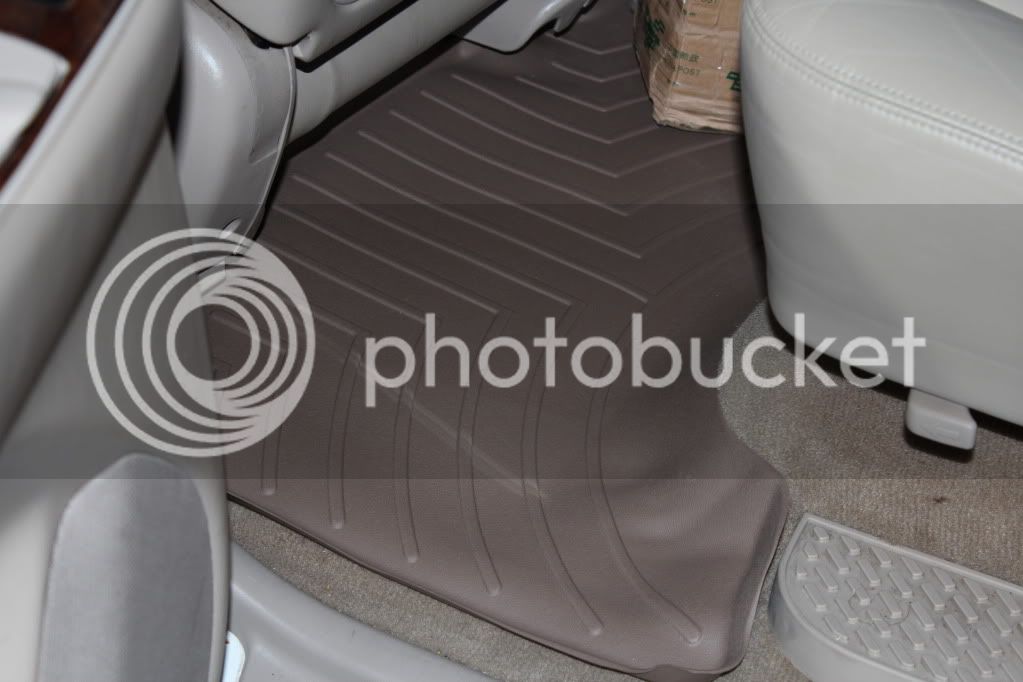

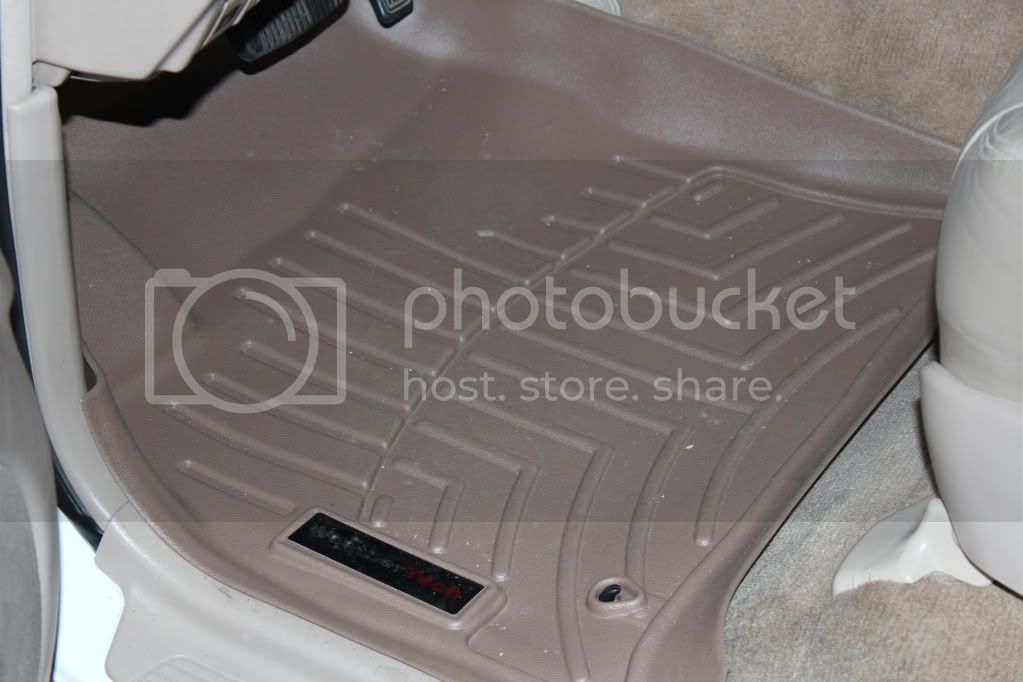

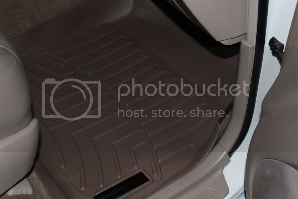

Weathertech's .....I got the front, middle, and the cargo mats.

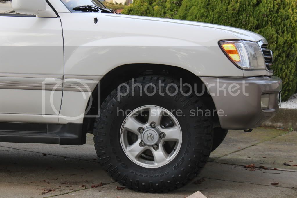

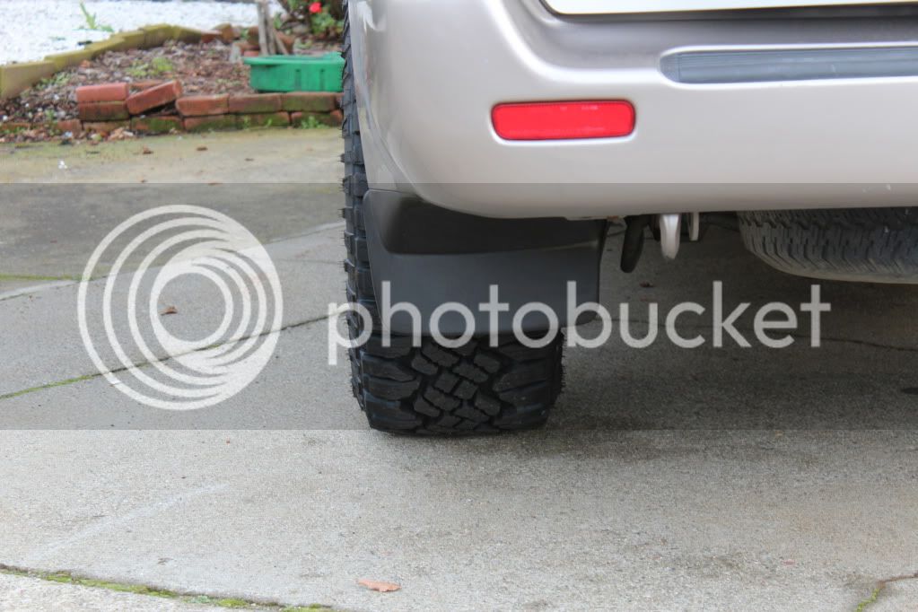

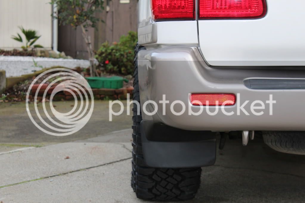

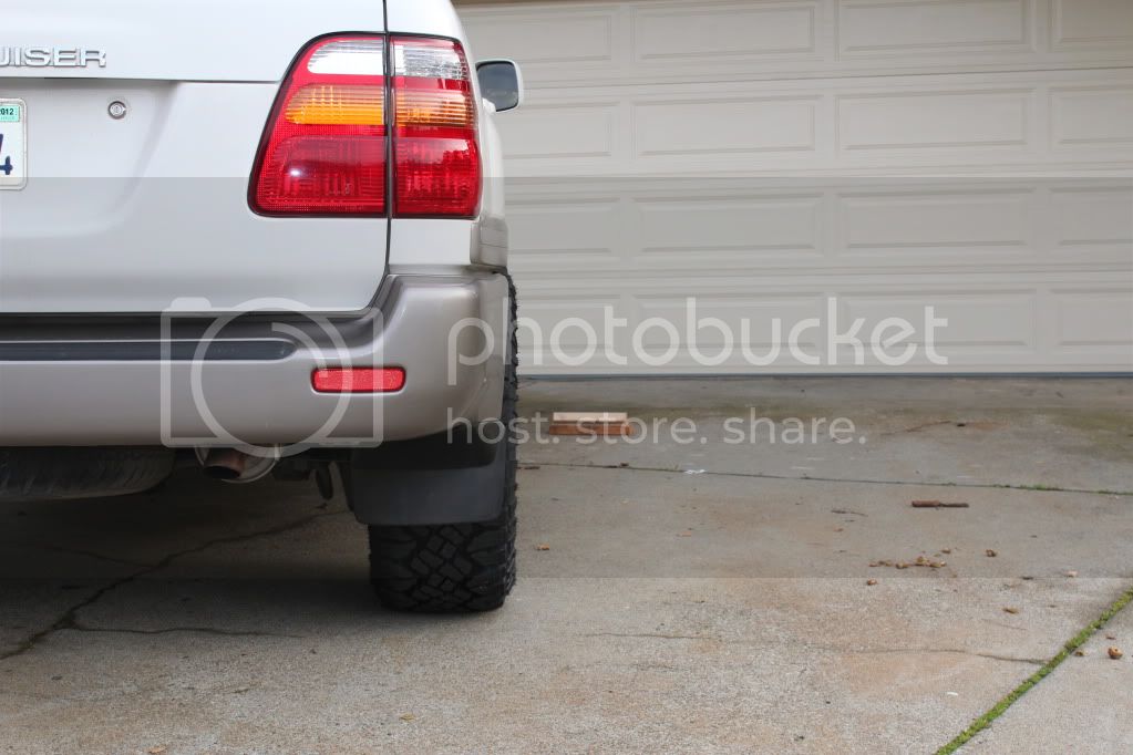

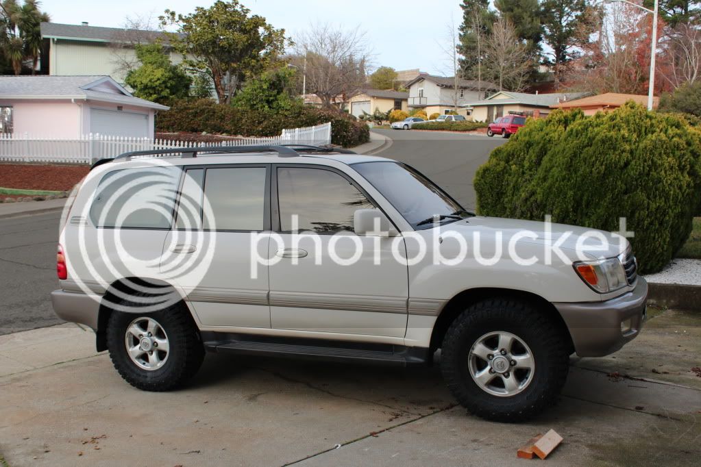

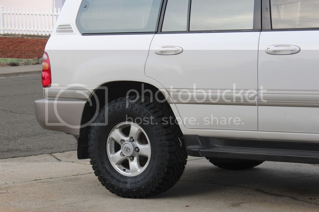

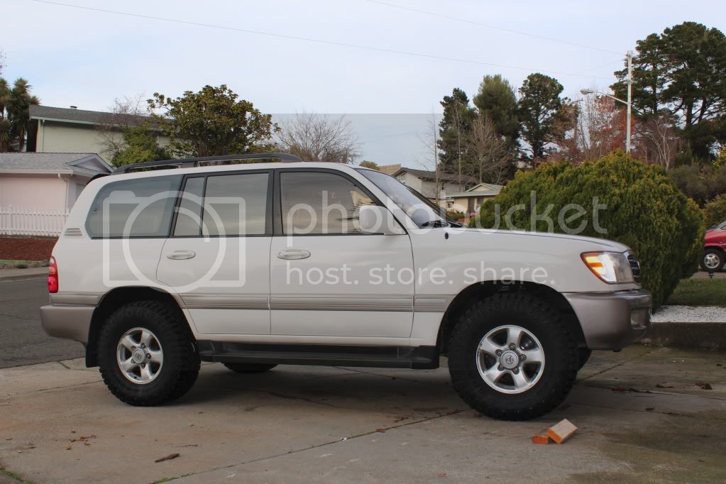

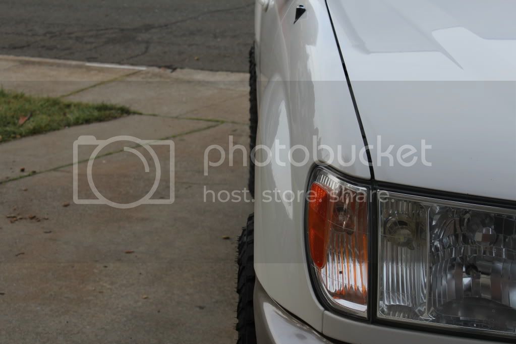

Duratracs Installed. Front lifter 2.5" ( might raise it another inch) These things are super wide for the claimed size. Im not complaining tho. !" wheel spacers installed Front and Rear as well. ( this is a must for Duratracs in a 305 with stock wheels, will rub very bad on the top of the spindle).
with such sweet tires, you need to quickly remove the rack, spoiler and running board to make this beaut legit...
Nothing wrong with the rack and spoiler IMO. Snowboard rack is getting mounted anyday. Steps are coming off this week tho. Keep in mind, this is my wifes truck. Mine is the beast.
Yes your 4runner is a beast! SAS and all! What size spacer in the rear? nice stance
Those weathertech mats look like a good fit. How does the cargo mat look?
Did the 1" wheel spacers require any trimming of the factory wheel studs? Where did you source them?
Looks really good by the way!
1" spacers front and rear from Just Differentials. No trimming as the wheel actually has holes on the inside. No need for HUB centric. The OEM wheel has an tapered base as well as tapered lug nut. THey are a great fit.

I got those weather techs early winter, best purchase idea ever. they save me from needing to vacuum the car every week in 30 degree weather. as for those duratracs i really like them and i want to get them for my cruiser however after seeing your rig im not sure i can fit them. i dont want to lift just crank the t-bars a bit and put 285/75/16's on, do you think that will fit?
285s will fit fine on a stock rig. The only reason he is running spacers is because he is running 305 series duratracs. Even most 305s will fit fine without spacers...the DTs are just a really wide tire for the size.
I have no lift on this truck. I just raised the front tbars like 2-2.5". These duratracs are very wide for a 305 tho.
Just curious why you went with the 305 vs the 285/75? The 285's are already wider than stock, and you would have actually gotten a slightly (Very very slightly) taller tire than the 305/70s, and of course not quite as wide. I'm assuming you really wanted a wide tire, just curious was this for looks reasons? Or was it cost?
The difference in height between the two is so minimal that you cannot even notice. THe difference in width on the other hand is significant. I prefer a wider tire. I think it looks great on this truck as well. The Duratrac is much larger it its claimed sizes compared to others tho. So far the on road manners are great thol The Wife loves them.
