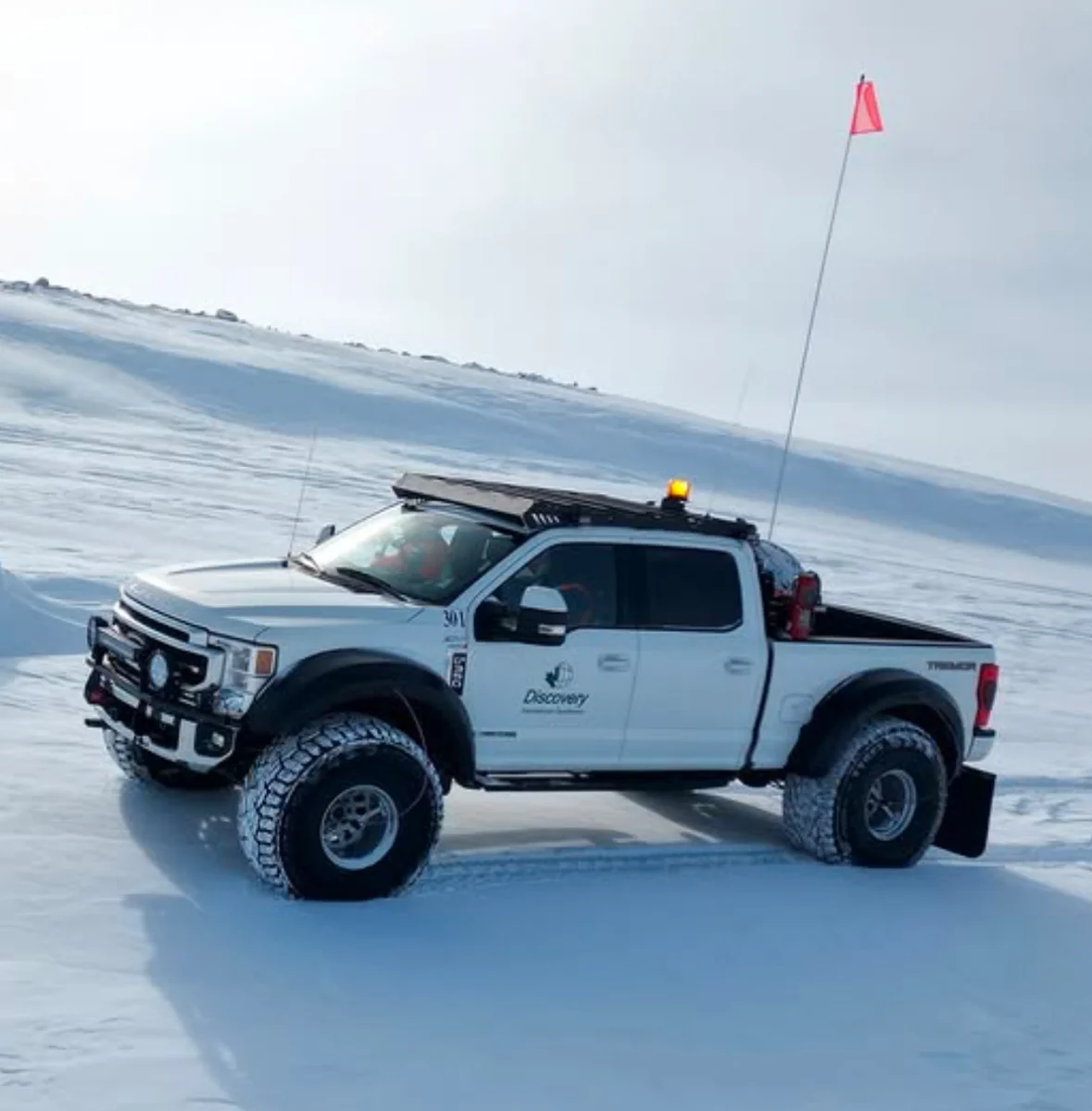

Hakka 44’s Knowhow from the Arctic: Robust Nokian Hakkapeliitta 44 winter tyre is the newest top-of-the-line product resulting from the cooperation between Nokian Tyres and Arctic Trucks / Nokian Tyres - https://www.nokiantyres.com/about-us/news-article/knowhow-from-the-arctic-robust-nokian-hakkapeliitta-44-winter-tyre-is-the-newest-top-of-the-line-pro/
And for fun a tundra truck on 44’s.

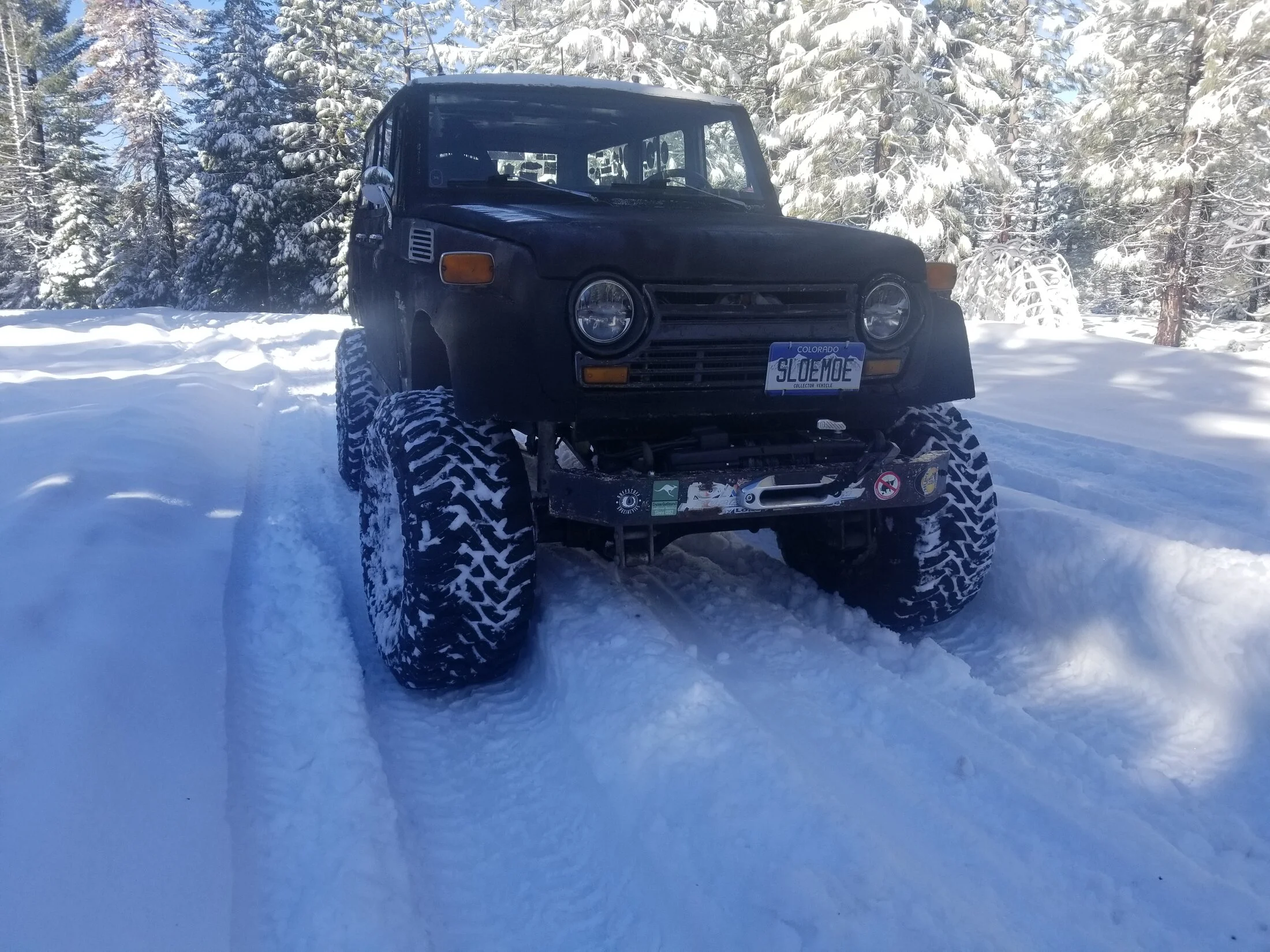

On one occasion it was 33x9.5s and 33x12.5s on the same day in the same place. Swapped between 35x12.5s and 38x12.5s same day, same place too on another occasion, as well as operating virtually identical rigs side by side on the different tires. Other times it has been identical rigs on 265s, 285s, 305s and 315s operated over the same roads and trails for longer periods of time. Ran 35x9.5s, 36x12.5s and 38x13.5s all on the same V8 mini truck over a few winters. Just to be clear, along with same day comparisons I mention here, I have run all of these different setups for extended use in winter time conditions.
For winter use I have run ATs and MTs of different brands and tread styles. Swampers, Boggers, summer street tires, all season street tires and dedicated street winter tires. And I have also used almost every type of these listed tires both with and without studs (yep, including the boggers)
In every case, every comparison... for street use the type tire matters more by an order of magnitude over the size of the tire. And studs rule. For off road snow, size matters more (and studs do little except on something like a bare frozen creek, river or lake). And in the end it still comes back to... when all else is equal, for street use on packed snow and ice, narrow has the advantage. Once you get into untrampled snow, or even rutted up but still not packed, wider is better.
If you are just talking about the difference between a 275 and a 285, or a 305 and a 315 in the same tire... stop worrying about it, you will never be able to tell.
38 inch swampers and 40 and 44 inch Boggers, "Icelandic" 44 inch Dick Cepecks and 45 inch tractor tires have all performed well for me in deep off road snow. But none would be my choice for a winter street rig. ;)
