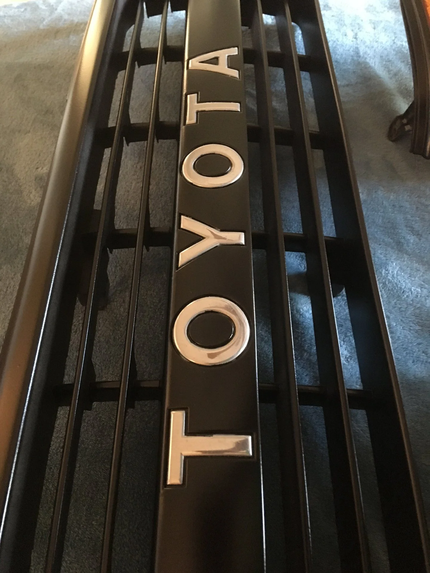

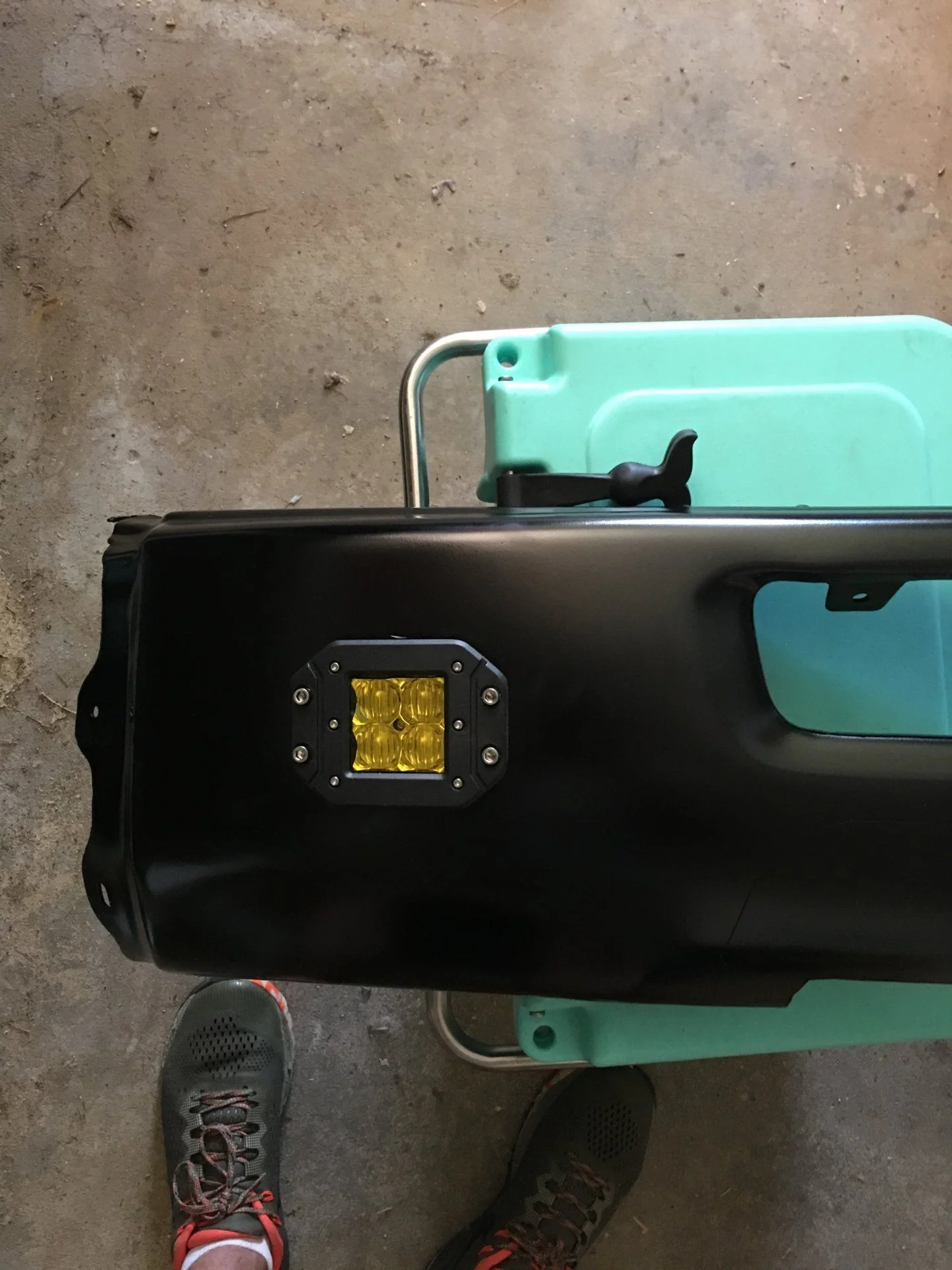

I used a single stage satin hot rod black on my grille and bumper looks great on the exterior.it was a 4:1:1 went on really smooth and has held up well so far.
