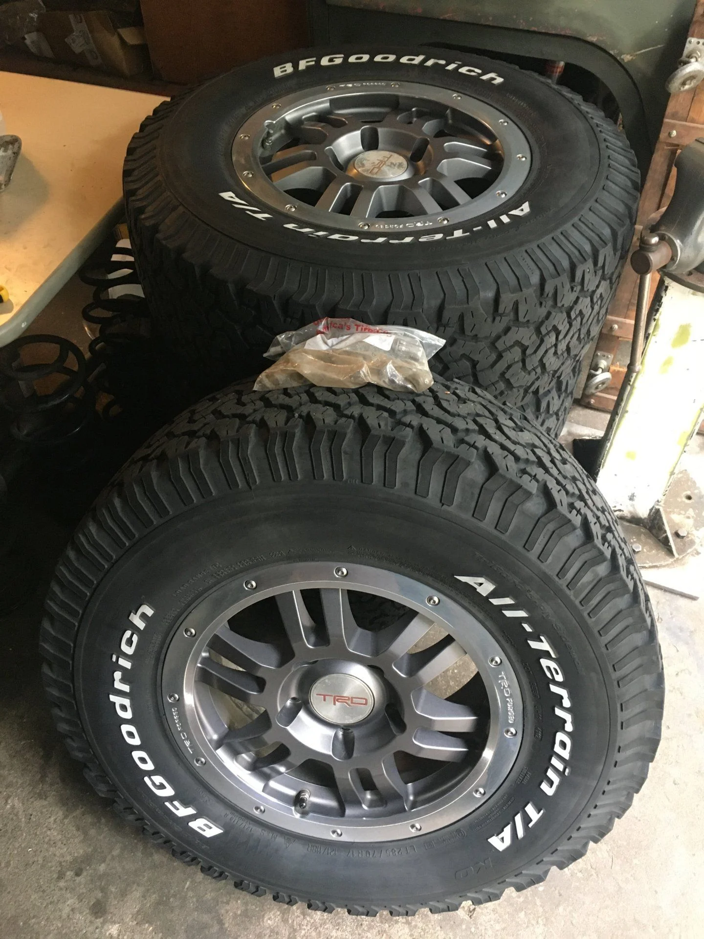

Scored a mint complete set today! :) Now to find a spare and a 100 to put them on 😂
I searched and found many RW threads but none specifically laying out the different ways to get them to fit. Of course there are 10mm slip on spacers, the wheels can be machined (exactly how?) and there are domed center caps available (anyone have a part number?). While I’m not against spacers this time I’m leaning towards having them machined and using the domed caps... Are the domed caps tall enough to clear without using spacers?
Nice find. Love the classic bfg’s - May want to check manufacturer’s date on those, although the rubber looks to be in great condition
I haven't checked the date on them but they do look pretty good. I'll probably just sell these as I'm planning to run the 285/70's in C load.

I have been looking for a few months. I was preparing to shell out a grand or more for a complete set but I was patient and got a steal on these.
TBH I'm more keen on the specs than the looks, the fake beadlock thing bothers me but I have a few ideas in mind to help with that. Anyone need some rings in good condition?
