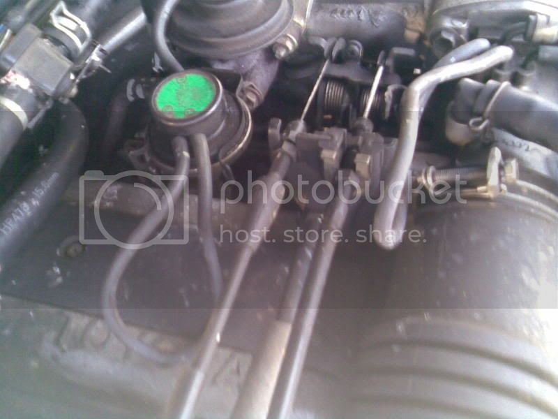

I have just swapped the vac lines of the EGR Vacuum Modulator over so that each end blocks the pipe next to itself - and done the same at the throttle body - have I disabled the EGR?
I have taken the truck for a spin - its starts fine - idles fine - drives fine - and doesn't throw any codes.
I don't have to have a sniff test until November so if I fail then reconneting the pipes will take one minute.

Only done the mod this afternoon.
I've just got back from a 40 mile mixed country lane and motorway drive. The EGR is fairly cool to the touch, and the EGR pipe itself I could hold a finger on it without burning myself.
So I guess this little hose change has disabled the EGR.
I notice that the truck feels a little smoother - maybe just a placebo effect - early days. I'll keep an eye on the petrol consumption and report back in a few weeks.
No engine check lights at all - but as stated - UK spec trucks are slightly different. We had locking diffs instead of OBDII lol :doh:

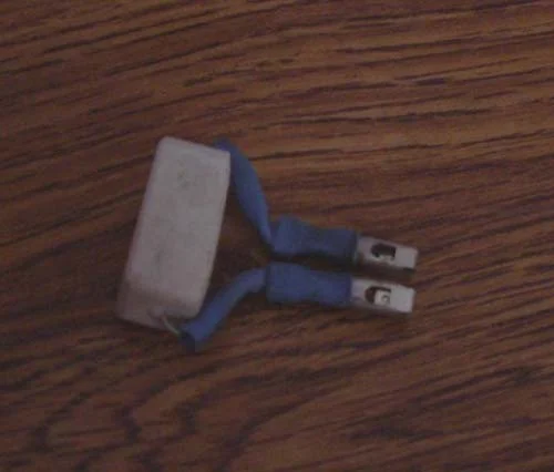

The internet connection at the school wont allow the pictures in this thread to show up, but I think the following resistors are the ones I should pick up:
1k-ohm 1W 5% Metal-Oxide Film Resistor (2-Pack) - RadioShack.com
$1.49
Model: 271-153
Catalog #: 271-153
From however the resistor set up in Bear80's thread looks different than any resistor I have used (like the ones used in the coolant-temp-mod). I know he soldered connectors to the end, but the actual resistor looks like a square block instead of a little cylinder with the stripes marking the resistance rating.
https://forum.ih8mud.com/attachment.php?attachmentid=19012&stc=1&d=1114557520
Is this just some sort of protective box he placed over the resistor to protect it?
