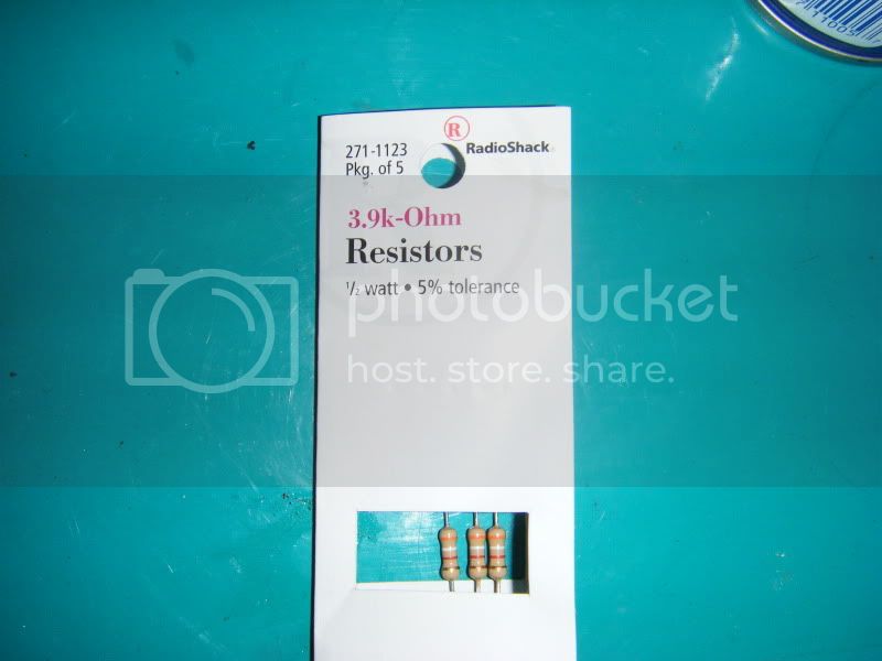

Still wanting to permanently remove the EGR valve, I decided to use a resistor as others have mentioned to "trick" the ECU into thinking it was still present. Here are a few pics:
A quick trip to Radio Shack got me the resistors I needed:
A little solder and heat shrink and I had this:
Once complete, I reset the ECU and plugged in the new bypass:
I drove around for a bit to make sure the engine got out of "warm up mode" and didn't throw another CEL. So far, so good. I have put about 600 miles on the new engine and EGR bypass with no apparent ill effects. My best highway mileage has been around 17.5 (300 mile round trip). I'm sure once the engine has a few more miles on it the mileage will improve, if only slightly.
I can't tell if the underhood temps are cooler, but I do know my wiring harness won't get burnt again.
^ is that resistor the same range that the obd2 trucks need?
My egr system is bypassed but not removed, truck runs better and gets better gas mileage. But in regard to the lean running wouldn't the ecu throw a code for it running lean? Not that I really know much about the topic.
The FSM has the specs for the EGR temp sensor.
122 (F) - 64K -97K Ohms
212 (F) - 11K - 16K Ohms
302 (F) - 2K - 4K Ohms
