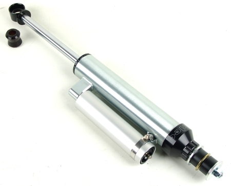

I was told the reservoir shocks are almost necessary for desert rallying and lots of quick shock movement correct? We do that more than rock crawling.
I was told that I may be okay with an OME shock. That would lift it more and would also be a lot cheaper than the slew reservoirs
