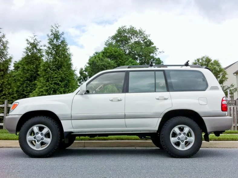

4peanut, thanks for the help. I looked at your cruiser pics and your front end looks about right. What's your measure from center hub to well? I feel pretty solid the way the lift is, but I would enjoy being the heighest I can get. Spacers? I was thinking slew reservoir shocks an then OME shocks in back?
I'm running Bilstein HDs all around, stock torsion bars up front, and OME 865's in back. My measurements are 21" front and 22.25" rear (865s netted me 2" to start, YMMV). I have had it higher than 21" up front, and while it looks good I do not like the way it drives. The steering is too light and there is a lot of torque steer under even moderate acceleration (i.e. not enough droop). Save yourself the money, time and frustration and follow the lead of those that have gone before us like spressomon, pfran42, and 1loudLX. These guys have some of the nicest 100's on the board, they drive them everywhere, and none of them are running a ridiculous amount of front lift.

I had 20.5" in front from center of hub to wheel well in front, and 22" in rear. Good? Anything I should adjust? I still need to replace the seal around the cv boot after torquing the tbars. I just got a fairly simple "tighten with a screwdriver " seals but the there aren't holes or slits in the track, just indents so it doesn't cut the boot, correct?
In order to get more than 2.5" lift in the front, you would need to drop the rear torsion bar mounting points, lower the entire front end, new steering knuckles, ... the list goes on. No one in the states makes a kit like this. There are a few in Japan that might but their durability is questionable. Also, there is little to no real world gain. You might be interested in doing a small body lift, someone on here was selling a small body lift to help people clear 35" tires.
Unless you install a diff drop. I wouldn't touch a thing up front.
