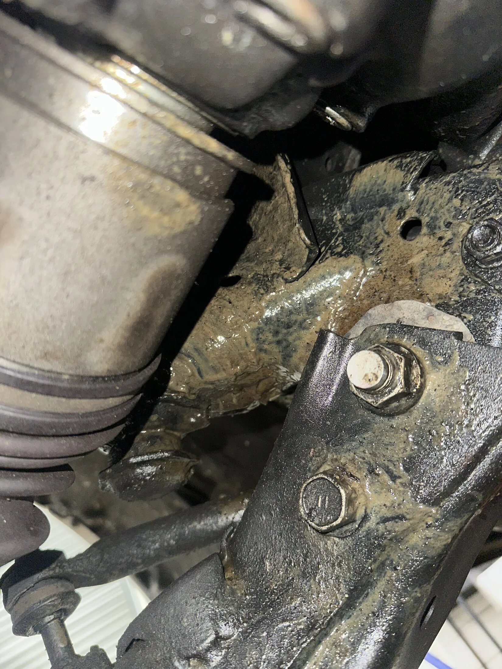

- grease thrown everywhere under passenger side undercarriage (my mechanic said the CV axle was recently replace , non OEM used possibly?

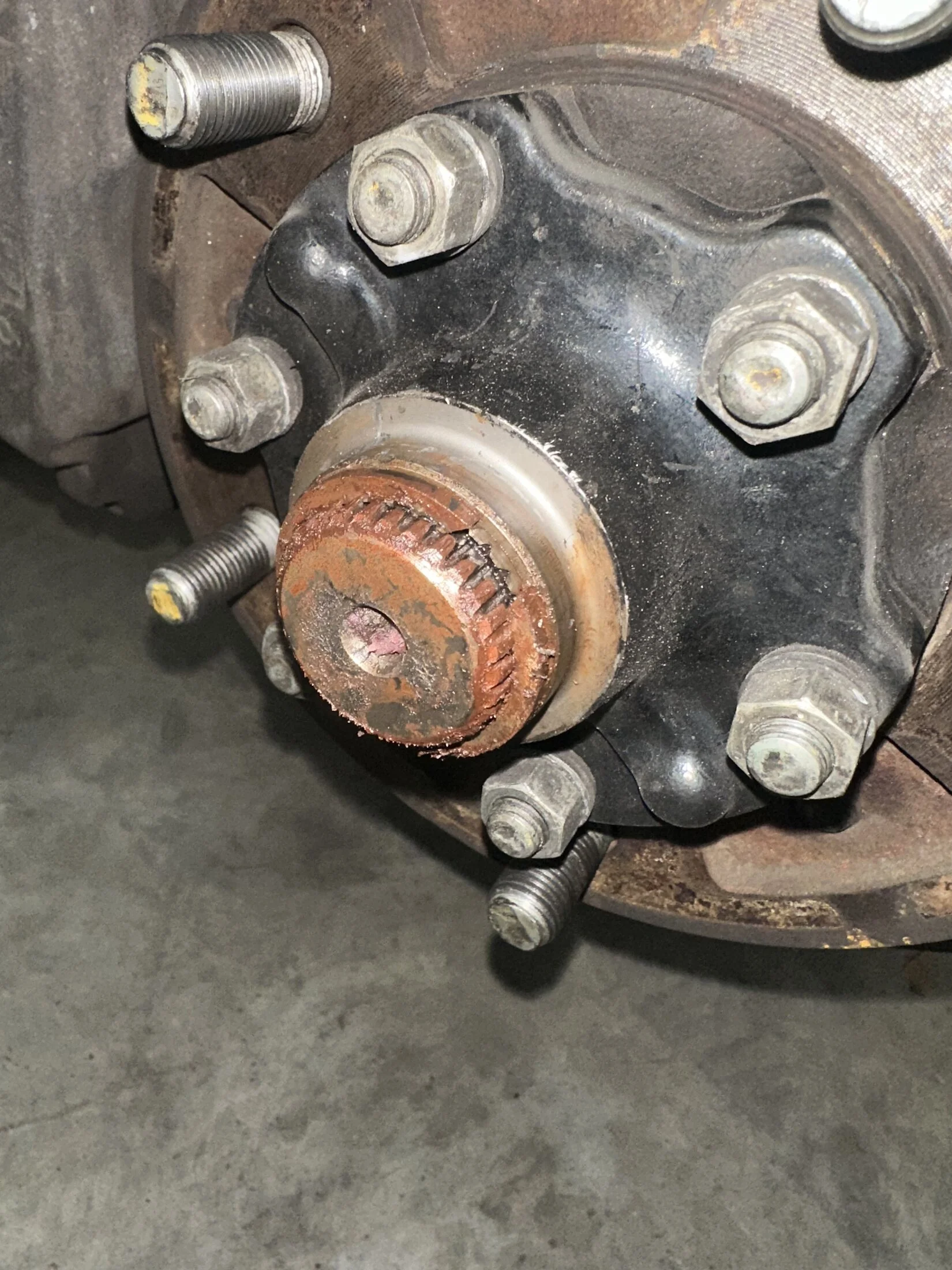

That's CV grease for sure. And judging by the looks of the outer end of the axle there's no way that one has been out of there recently.
With limited info I'd be planning to do that axle, and bearing service on at least that side.

I'm not so great with links here but be sure to educate yourself about the wheel bearing service and fitting the correct spring clips.
Just look for axle/CV threads.
