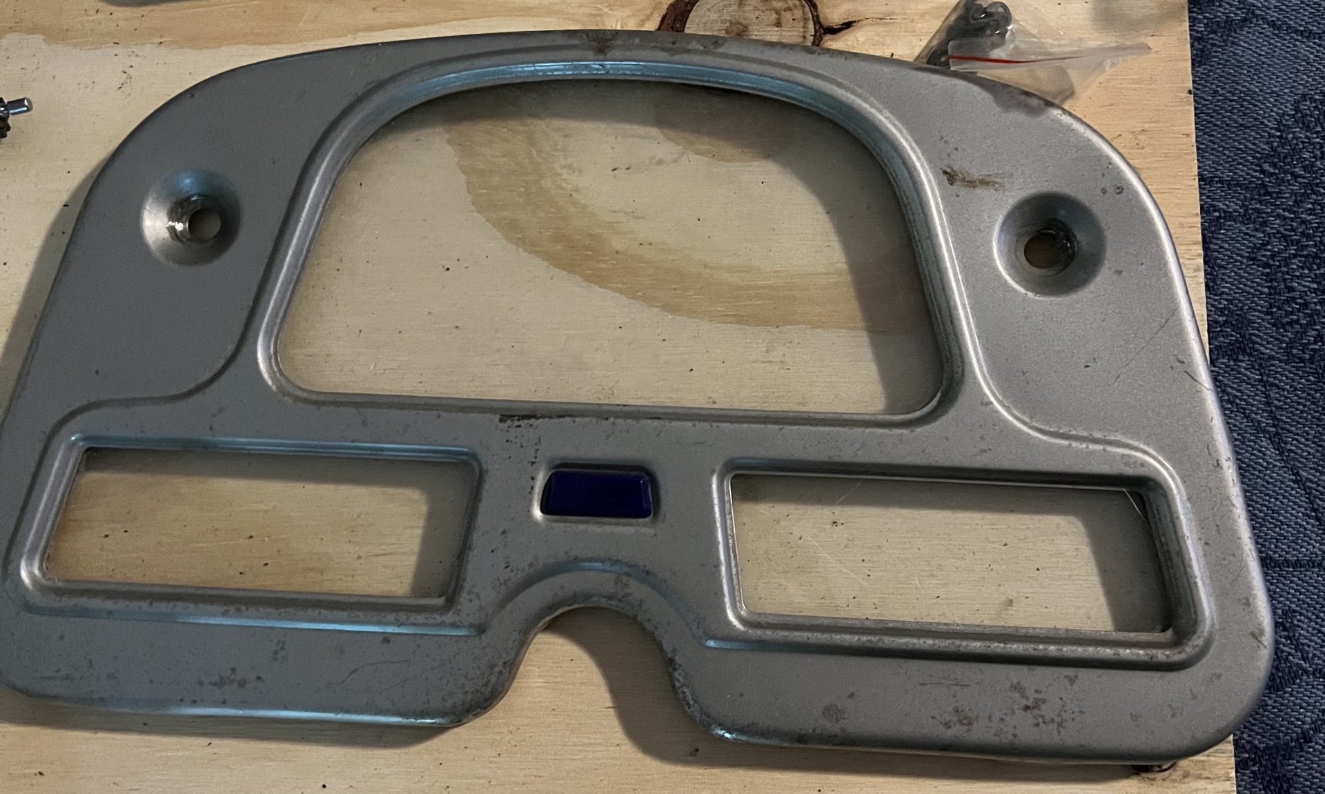

While waiting for parts to put my Dash Gauges back together, is there an official color for the dash so that I can repaint it?
Oct 10, 2020
14
123
Near Omaha Ne
I've got the whole unit down to individual parts and there is some light rust on the surface of the metal front face of the Gauge/Speedo cover that means now would be the time to sand/repaint it. My FJ40 is a 1976 and I would describe the color as a muted silver right now. I could just paint it some grey/silver color but if there is an official name and color I can buy I would use that unless its hard to get or very expensive..
Search "pewter"
Cruiser Corp sells a rattle can in pewter for $21.

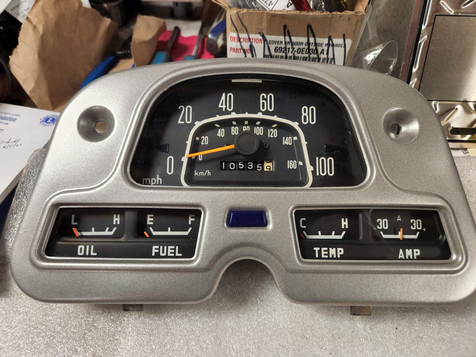

Thanks. I looked around for other options but this seems to be the best one. Ordered a can.
I used Cruiser Corps pewter rattle can. Works well.
I would say that my instrument cluster, and glove box door turned out a bit more silver/gold than stock - kind of a champagne color vice the more grey pewter that came on my new OEM bumperetts and replacement instrument cluster (yes, I rebuilt one and bought another...).
I'd still recommend their products and have used the 857 medium blue on other parts to great effect. The slight variation is probably not noticeable to a passenger, and maybe not even to a cruiser enthusiast. I only mention it to suggest you consider a dark primer (mine was white) to try and 'grey' up the finish a little bit. It *is* possible that I didn't shake my can enough, or maybe too much, or that I should have put on more coats (I used two).

End of the repaint and odometer repair questions, at least for now. Thanks to all for advice. I ended up getting the Cruiser Corp spray paint. It's delivery went from unknown to tomorrow in space of 1 day. Looks pretty good to me.
I bought it from Cruiser Corps and there are a couple of numbers;
Brand Code 4048
OEM Code T309
If I remember correctly I ended up searching for 'Pewter' spray paint on the website. I don't think its an exact match, but its close and looked a lot closer after I let it dry for a day. Kind of expensive, but I wasn't finding anything close, and I was getting really high prices to powder coat it. I think if you can find a powder coat painter that regularly handles FJ 40's the price wouldn't be as bad. I was told that there is a minimum quantity of paint they need to buy and if they aren't other people wanting to paint you have to pay for that minimum amount they need to buy.
