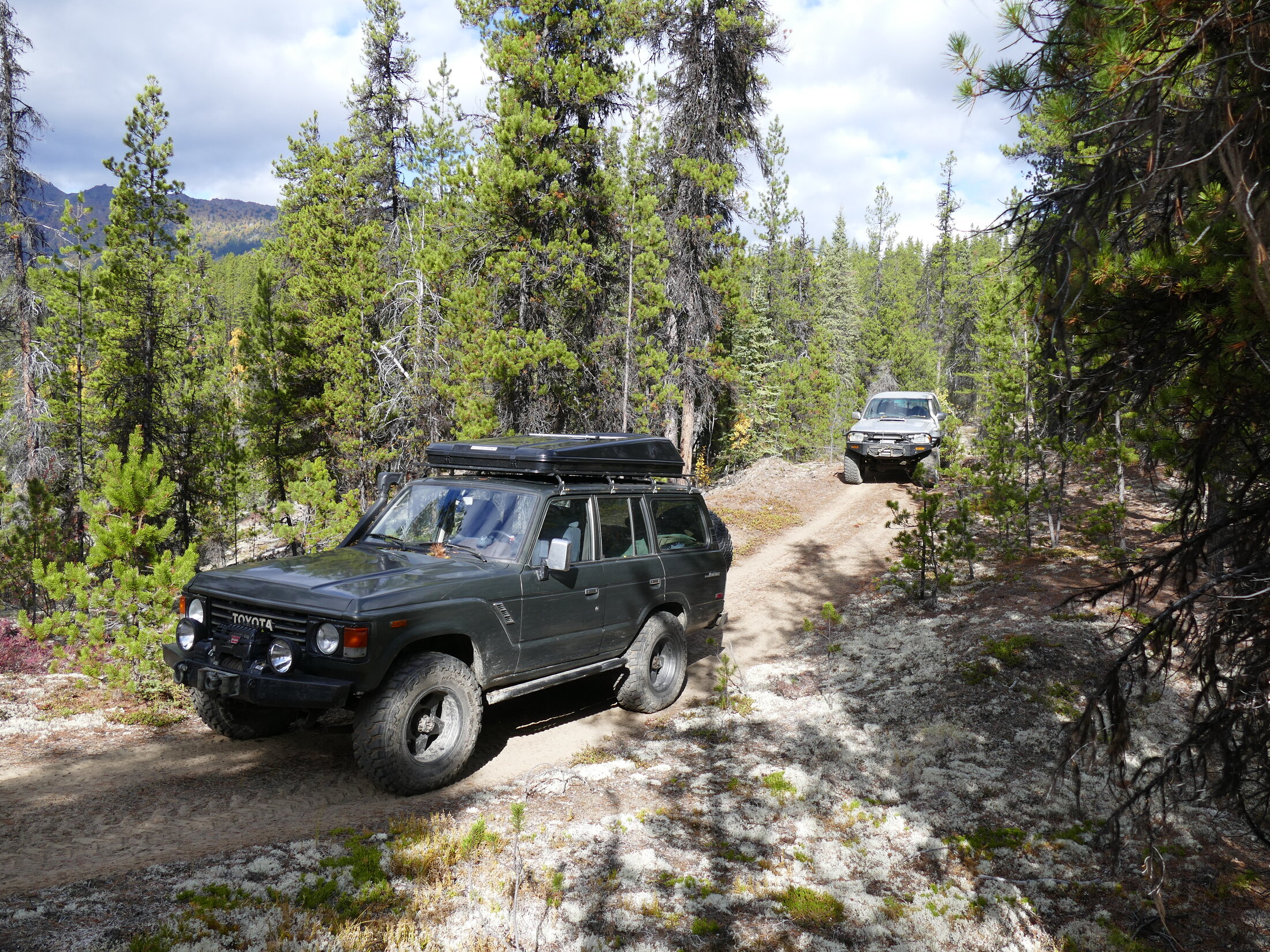

This 12HT 60. With normal 265/75R16 tires. No giant lights. No rear winch. Add AC. Rear sliders windows with steel grate
over screen protection. With new vertical pop top. Since a normal trip is 3-4 weeks and carry 2 months of food at any
one time, there wouldn't be any other differences.

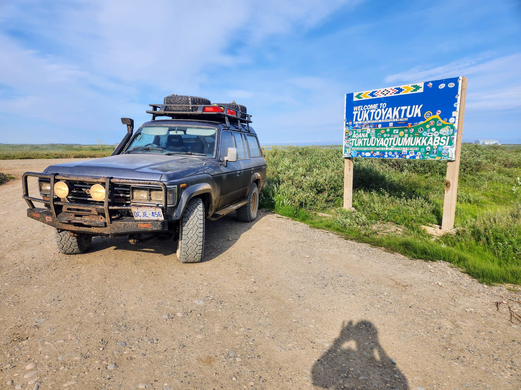

Enough though i have a fj80 and a lx470, i elected my hj61 12ht high roof, to be my main long distance overland rig.
Picked it up in Vancouver and did 10k kms in 23 days, through Dempster Highway, artic ocean, all the way to Toronto

I avoided the common route thru the prairies. Boring as hell. went thru a much nicer area of northern Saskatchewan and Manitoba, beautiful lakes up north in Manitoba.
Unfortunately Jasper burned down just 2 days before we got there.
Epic trip.
