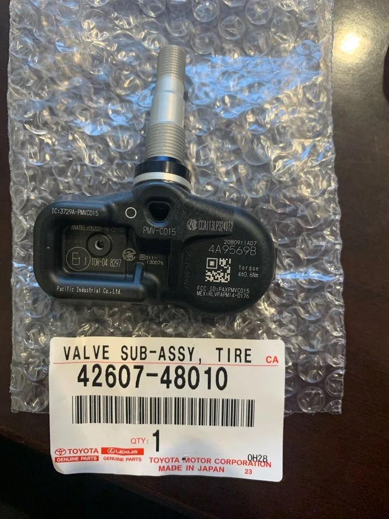

Keep in mind that "Toyota" genuine packaged sensor is just a Pacific Industries PMV-C015 that you can get many other places for less money, and Denso sells the same Pacific PMV-C015 in a Denso box with their own part number. And with Toyota, you have to buy the fit kit pieces separately (nut, rubber seal, metal washer) for each wheel.
Nothing else out there compares to the longevity and quality of the original sensors, whether sourced from toyota or saving money with (OE supplier) Pacific Industries parts in Denso boxes. For some parts this isn't as important, but a faulty sensor here means opening the tire/wheel to service it.
I know you know this but someone coming along later may not, the PI/Denso number is specific to certain years. This will work for 19 but people should verify the numbers before assuming it will work with other years. I know for a fact the earlier rigs use a couple different numbers.
