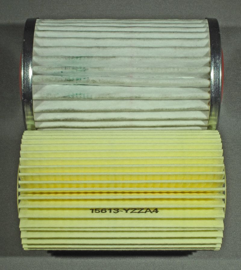

Here are the two oil filters I have used to date in my 2013 LC200:
The one on the left is the Toyota OEM filter and the one on the right is the Toyota TRD Performance oil filter.

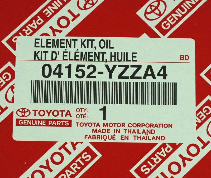

The OEM filter is made in Thailand:

Dimensionally, both are very similar:
The OEM filter weighs 1.6 ounces and the TRD filter weighs 4.7 ounces.

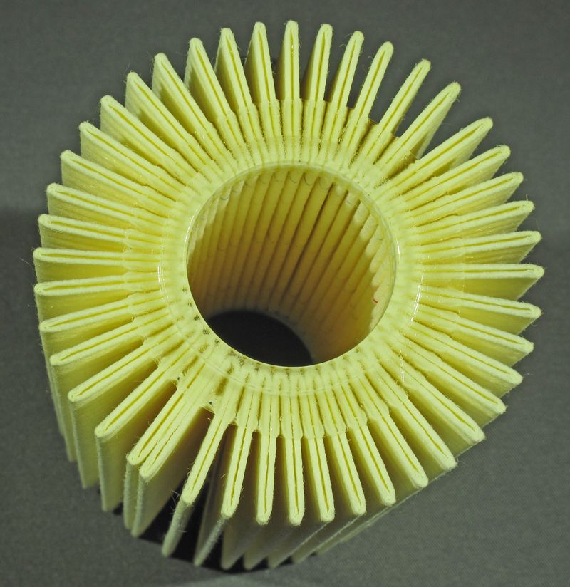

The OEM filter has a hard plastic molded into the ends:

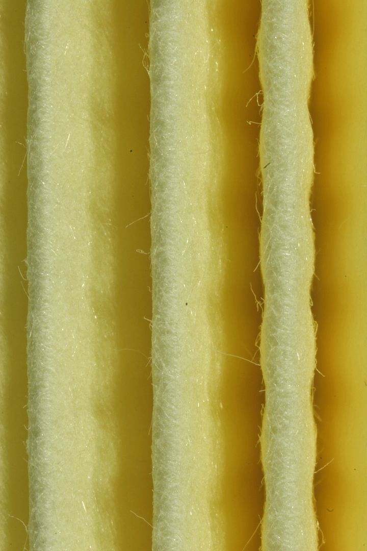

This is a 1:1 photo of the OEM filter media:

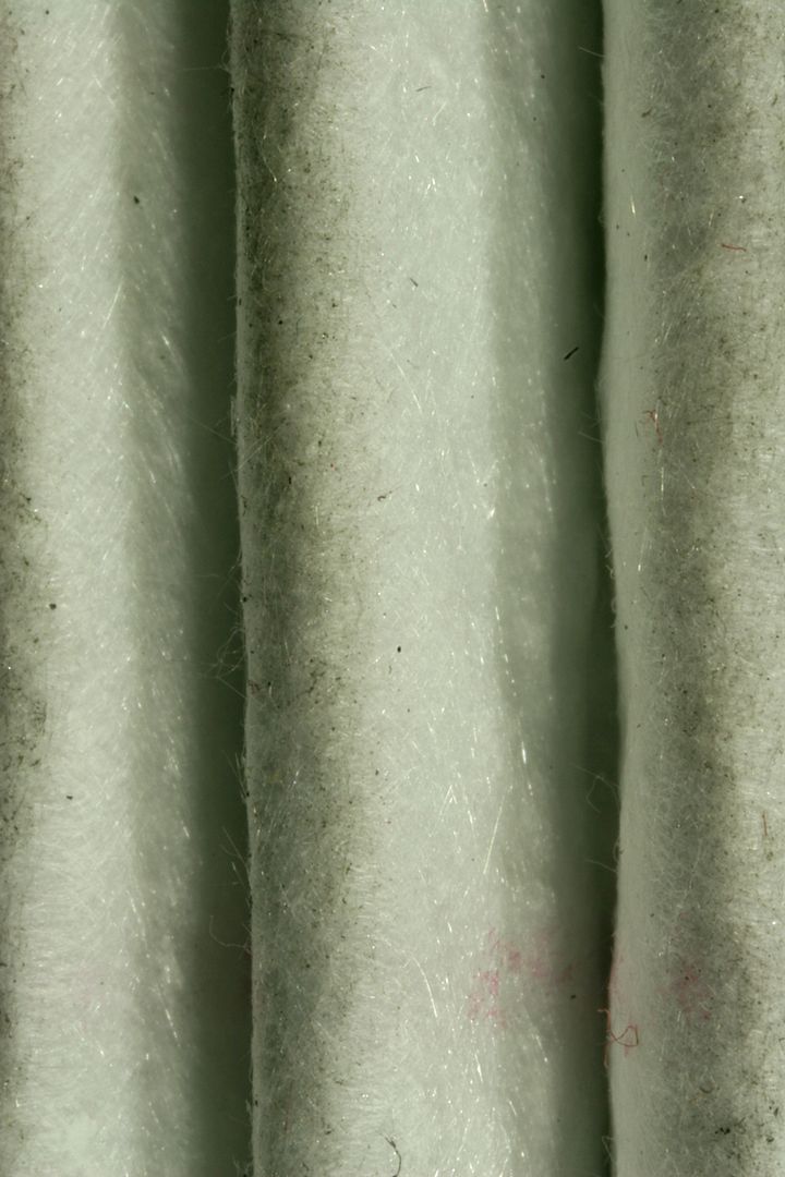

This is a 1:1 photo (exactly same scale as the photo above) of the TRD filter media:
The OEM filter has no reinforcement on the inside of the filter:

TRD High Performance Oil Filters incorporate state-of-the-art design and materials offering superior protection. The filter uses 3 plies of 100% synthetic glass/polyester blend filtration meida that 98% efficient at 20 microns - that's smaller than pollen.

Nice post. Do we know anything about the filter media used in the OEM filter? Sounds like the TRD filter is 100% synthetic which is what Im looking for. From what Ive gathered, running good, full synthetic oil through a filter with 100% synthetic media equals long oil change intervals.

After reading that TRD info again, sounds like the media is a synthetic blend. The Amsoil filter is 100% synthetic, according to their site. Anyone know of any other filters that are 100% synthetic?
