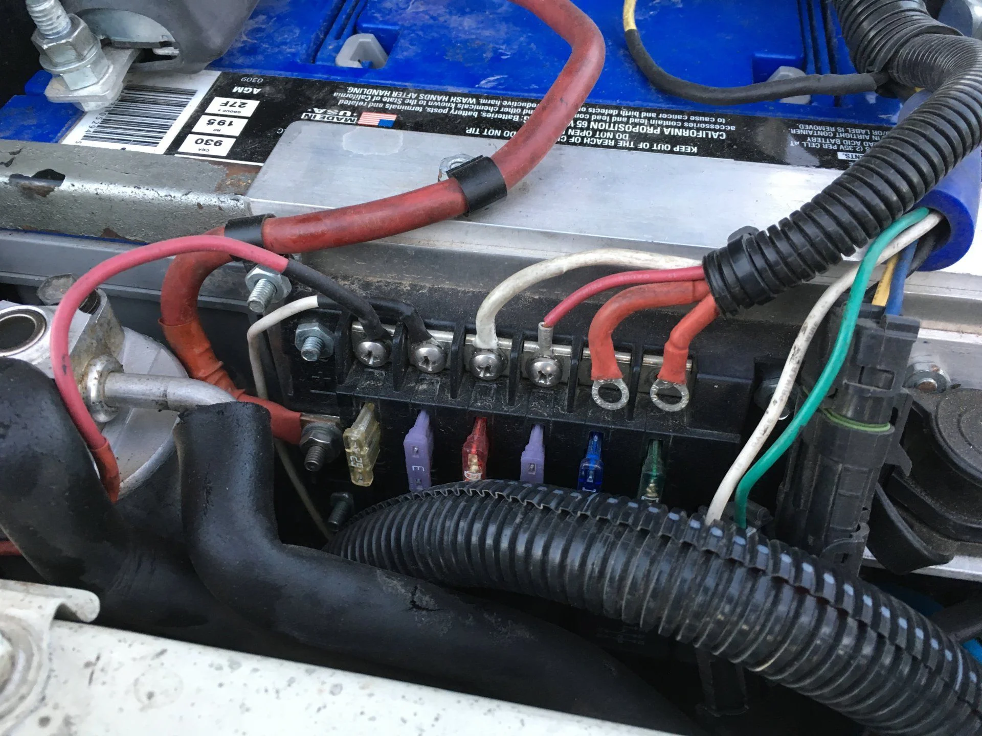

Just as a heads-up: I have a BlueSea fuse block mounted in front of the battery.
Yesterday, after about 40+ miles of rough & rocky trails, I found two of the screws had unthreaded themselves...

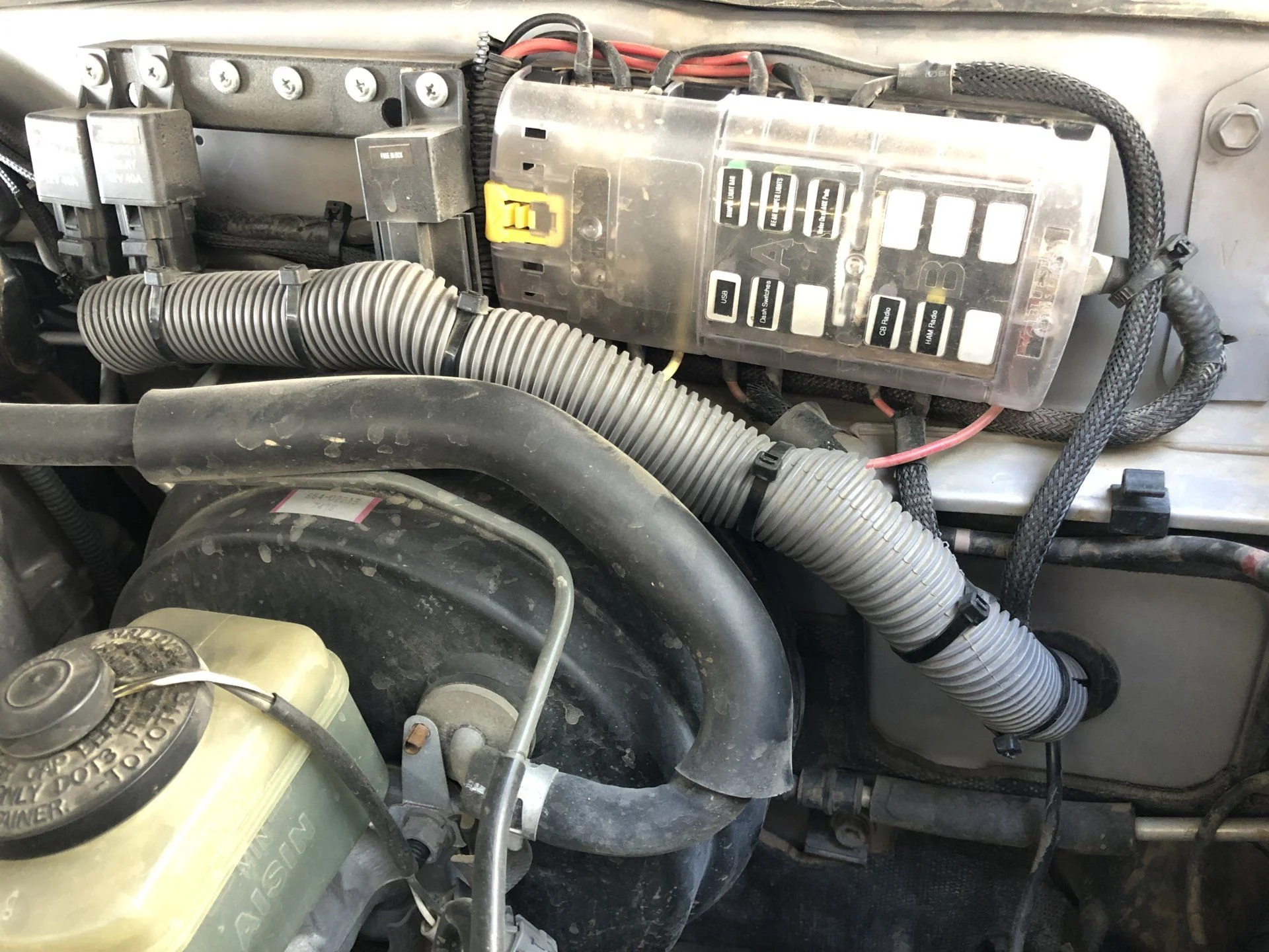

Maybe a little more to properly install if you dont have a pair of the required crimpers, BUT the bussman is water/moisture proof, nothing to rattle loose.
I'm not familiar with all the BlueSea models, but the bussman can be setup with relays in it. The good kind... The ones you find in modern OEM applications. "Pound for pound" the bussman is smaller from what I've seen.
Cool, good to know - yeah, I bought one of the Bussman that a forum member was selling awhile back, I got mine 2nd hand from a guy who never installed in his 80.
That makes sense why it has pigtails coming out from the underside, must be that proprietary crimper used so all us end users just need to solder & heatshrink / crimp butt connectors to the pigtails to do installs.
