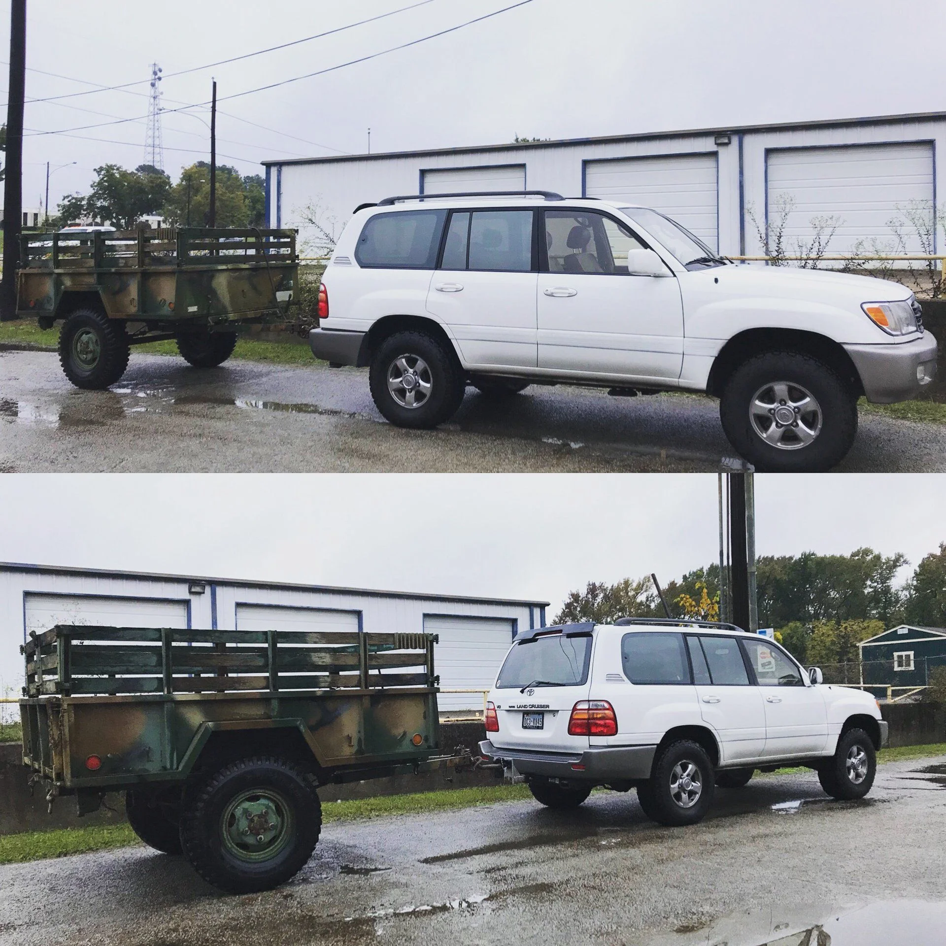

I purchased the airlift kit 60728 for my stock springs and 30mm spacer. I ended up cutting/shortening the bump stop that resides inside the spring to 1" tall. There is an indention at exactly 1" where I cut. This basically gave a stock length. It works great! I towed my camper in style with only 15 psi and had no sagging and no tow hop.
