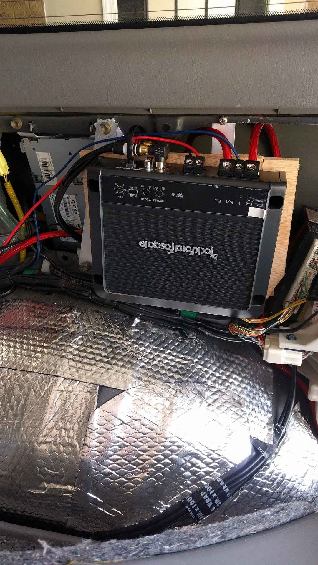

that's a little bigger than the RF I had behind the panel on the passenger side forward of the rear AC unit, but it might fit there. I had it mounted on a square of 1/2" wood. If you went with thin aluminum mount it might work well. Other side probably works also. I noticed the passenger side had more mounting options, screw holes already there, stuff like that. Also I liked power wire on that side of the LC. The again you'd have to measure.

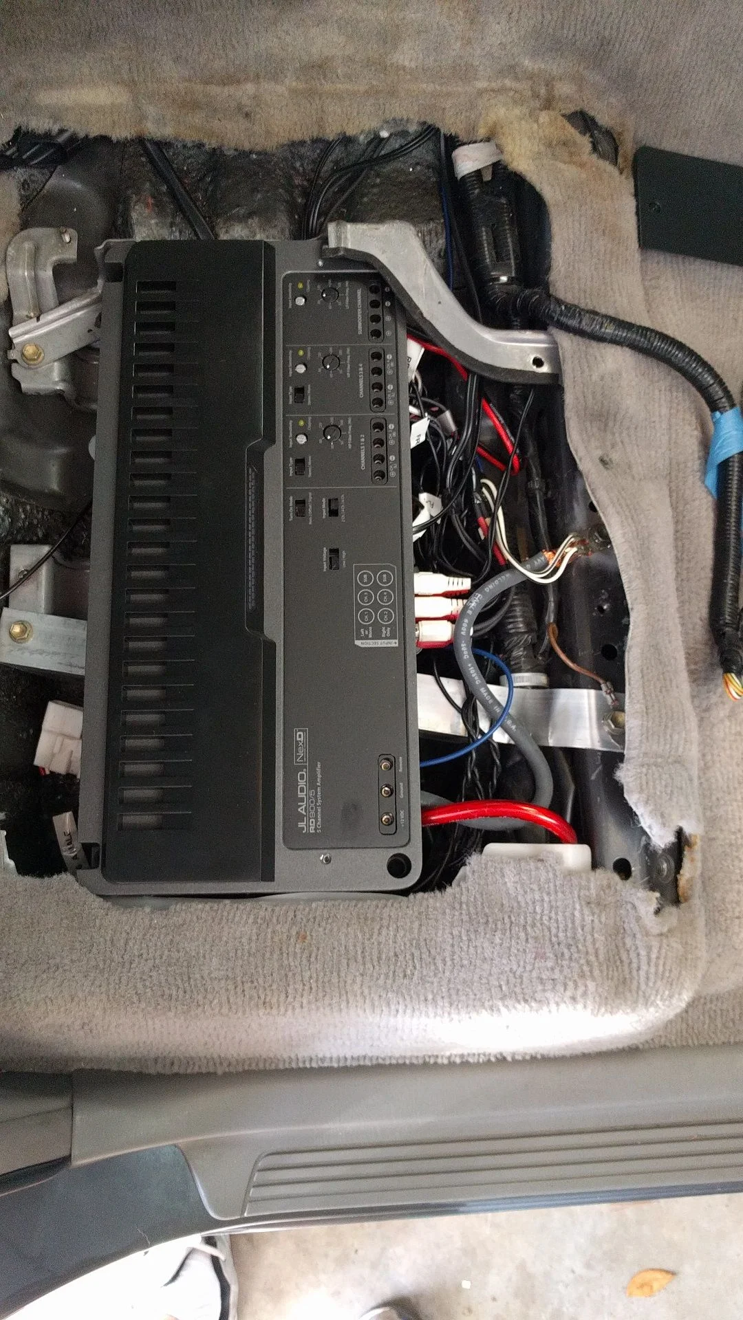

It's probably too tall to mount under the seat on top of the stock amp. If someone were to lower the seat it would for sure come down on it. You could make seat risers under the mounts, but it's limited geometry wise because it stretches the length of the rails at the same time. I have used two thick washers on all four briefly on this truck until I finished the install.
That t3002 is a nice amp. But honestly, the space available is limited, even if you ditch NAV and stock amp. Class D isn't so bad considering efficiency and physical size.
I already made stagered spacers to lift the passanger seat, I guess I can just make them a little taller to gain the little extra space I need (taking/cutting the carpet will also help..)
consider this amp in the pic is 1.98 x 6.77 x 8.5 (in) I lied, that's 3.8" plywood on there. Also consider more room forward in front of the AC amplifier if you have one. You're looking for 5 more inches long... and looking at it now I think you're vertically challenged. idk man.
Don't bend the seat mount feet if you raise it up too high. Ditch the NAV ecu an set it on top of the stock amp or remove the stock amp and set nav back on top of your amp. It's messed up under there for sure. Bite the bullet and take out both side panels and have a look.
you say you don't have space under the seat? I read your first post again. this is 15 inches wide. No clearance issues. It's off the deck by an inch or two.
Sorry..
My AMP is about one inch to long to rear at the very bottom of the ''bowl'' under the seat, mostly do to the diagonal shape ''hump'' in the back of the structure..
Side to side it has about 3/4'' clearance, I guess I better take the seat out and do some more precise measurements and also take some pictures..

Short story if I fit it ''Belly Up'' and with the connectors to the back of the seat it will fit, not optimal but it will fit nicelly..
And if I lift the seat rail mounts about 30mm higher (not so good for me and my silly long torzo) I can fit the second on right side up on top of the other one..
