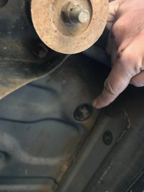

I’ve got a little bit of water in dripping in and I want to make sure my sunroof drains are clear. Supposedly the PO had the dealership clear them a few months ago. I don’t see any debris in the perimeter basin, but when I pour water into the drain holes, it seeps out of the pinch seam under the rocker panels. Shouldn't there be a rubber tube poking out under the car where the water drains?
I ran about 4’ of wire into the drain holes before it stopped feeding in … somewhere.
