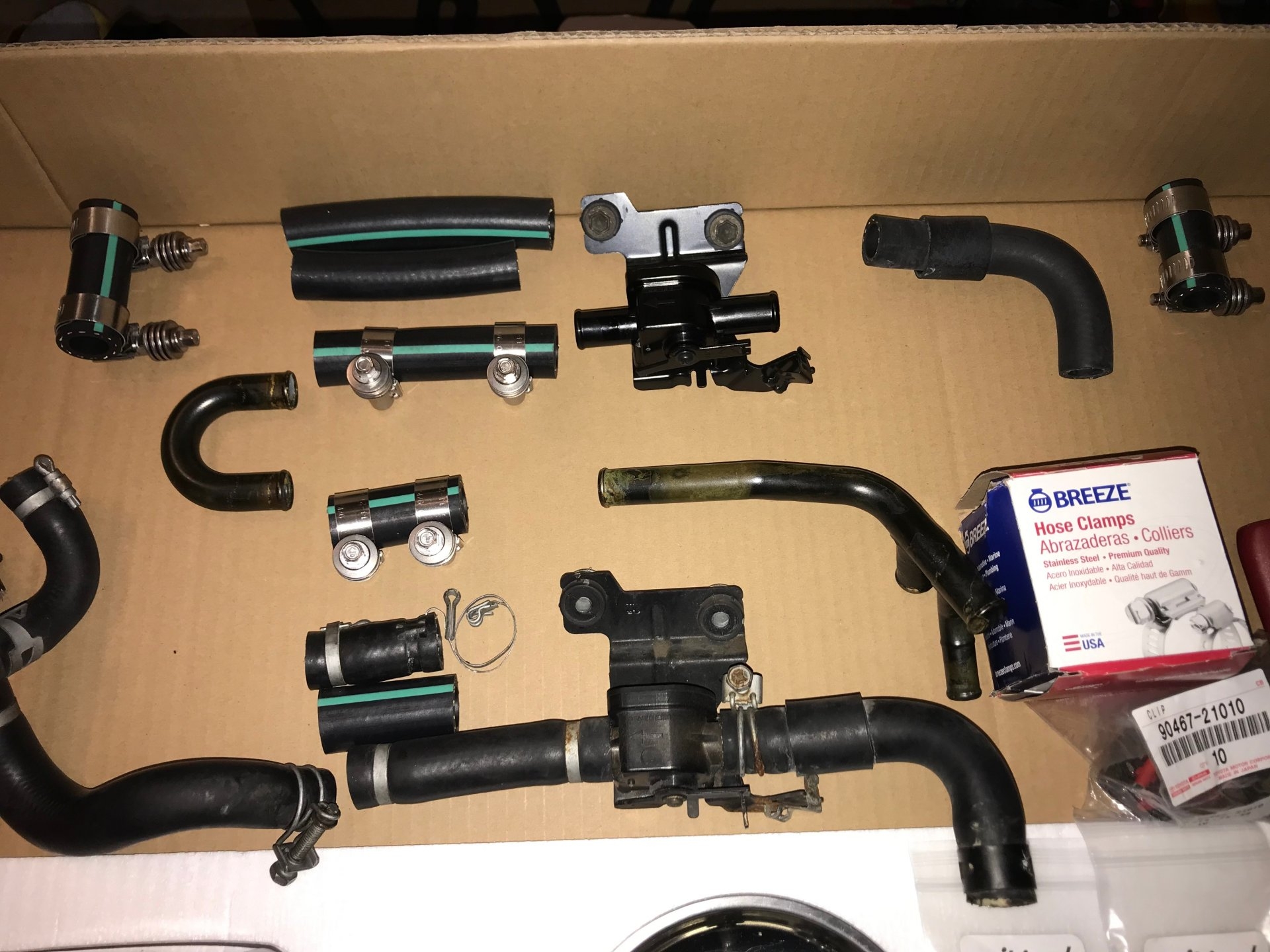

my radiator is still good, but my hoses... not so much. went by wits end and picked up the T fitting and some of those wonky hoses out by the passenger side. went with OEM clamps, just making sure it fits good before ripping off the red tabs.
Also decided to replace the firewall hoses which are straight with the gates green stripe 5/8. Problem is that the gates hose is so wide, you can only use the breeze clamps on it... didn't know that. Learned the hard way, but this setup should last 20 years or more. I also did the PHH while I was there, so check on yours.
Next is the small heater hose, the ones that live under the throttle body. known as PHH #2 or something like that
Mr. T does have some clamps that will fit the green stripe. Heavier duty and just a tad wider. I just installed some when I replaced the lines to the rear seat heater this weekend. I believe the part # is: 90461-08706. Unfortunately, I had ripped open several bags and would not bet more than a lunch on this.
