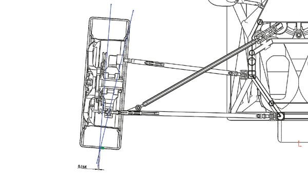

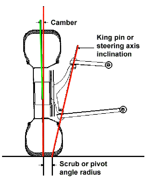

Consider this:
The bigger the scrub radius, the more power steer, wobble, wear, etc.
When increasing the tire radius, the scrub radius is reduced. When using spacers, the scrub radius gets bigger/worse.
Here's a perfect set-up:
